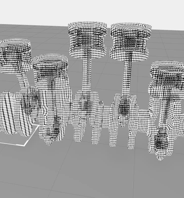

Apr 1, 2021 1:07 AM UTC
Thank you for presenting the information
I'm trying, but I haven't done it yet.
The TML text of Vuforia Studio only describes the vertex shader and fragment shader. Is this feasible?
It is the content that I am trying variously
I'm aiming for a look similar to a wireframe, but it's a little different.

Apr 1, 2021 9:58 AM UTC
Hello Okuno Takahiro,
Yes, I think it is possible.
After looking in more details the source code of wireframe shader, I have tried to import it in Vuforia Studio.
Please find Project attached.
But it doesn't work for the moment.
It seems something is wrong in fragment shader.
It needs more work to have this effect work fine.
