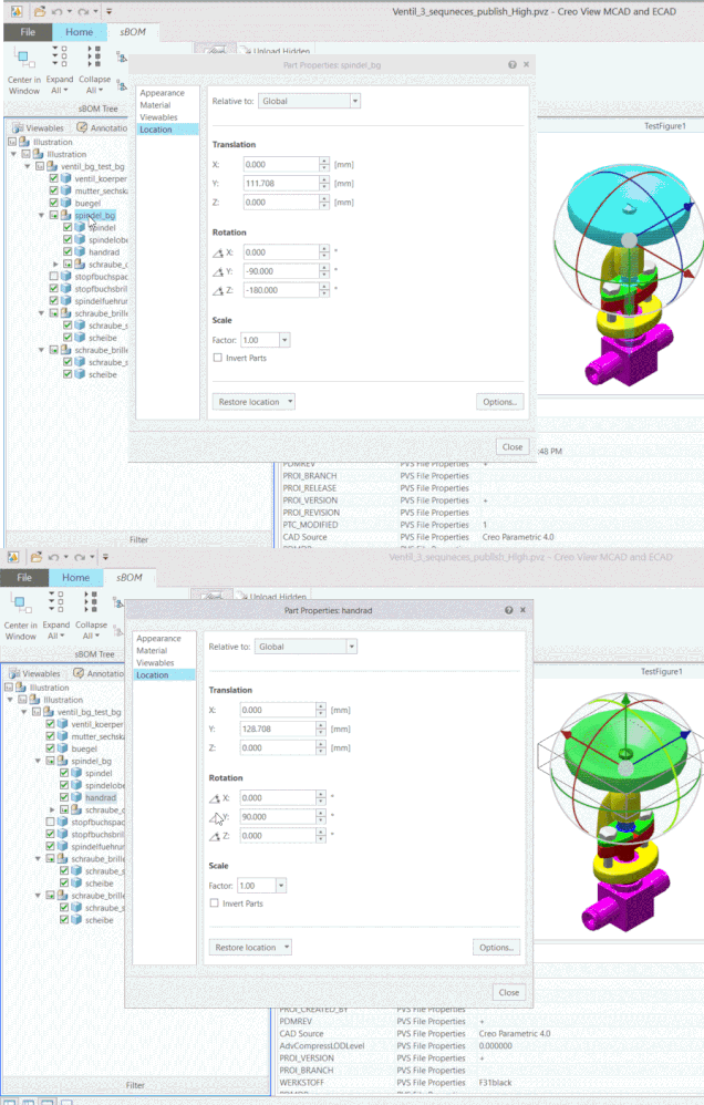

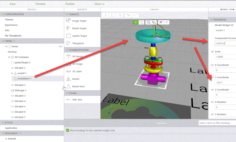

So for example we have a model (an assembly) . When we create a modelitem for a component with the path e.g. /0/0/3/2
When we check the geometry of the assembly in Creo View we have then e.g.:
So here in this example we can see that the coordinate of the modelItem is a difference of the both coordinate:
0.017m = 17mm = 128.708mm - 111.708 mm
So means that we can calculate the coordinate of all components in Creo View ( Creo View Toolkit) and create a json object which contains an comp path id /occurrence  , coordinate x,y,z ,rx,ry,rz and track all changes what we do in studio to know the correct component position.
This is as mention, definitely not  simple , because we have to calculate the postion of each component in regards of  the accumulated movements along the id path. (so means we have to accumulate the movements  (x,y,z ,rx,ry,rz) of  e.g.  /0/0/3 /2 to the movement of /0/0/3 ( the subassembly containing the part)
More complicated is if we move the subassembly and the part .... in this case we have to consider the both movements. In creo the positions of the components along the component path is considered by transformation matrix where we can simple multiply the matrix to find the end position. In Creo View and in thingview we have a Euler coordinates(x,y,z,rx,ry,rz) but there are also some javaScript libraries which could be used to calculate the correct coordinates
