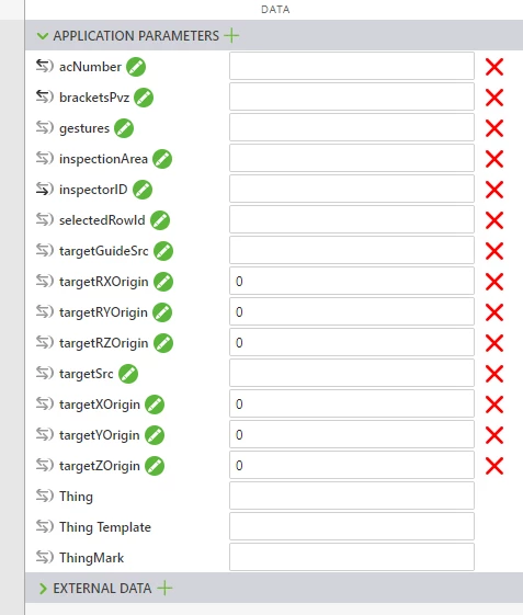

We need to be able to dynamically load a model target using Java Script. This will reduce the number of experiences we have to create significantly. I was given a sample by PTC that shows how to do this, but I keep getting a message that reads 'Error loading tracker data' and it never actually loads. Just FYI, I am trying to load this from a THINGWORX REPOSITORY located in the same server as Vuforia. This is the sample:

You can clearly see that several of these properties are set by Application Parameters. Suffice to say that I properly added those parameters previously.

$scope.app.params.targetsrc='vuforia-model:///' + targetPvzFileName;
$scope.app.params.targetGuidesrc=targetFilePath + areaName + '/' + targetUUIDname + '.png';

Hi @HectorAtLmco ,
here is a sample project  on the github which is related to your quesiton and possibly could be helpful:
https://github.com/steveghee/partAI-experience
but ...
  1. a model target data is  saved in subfolder of the upload project folder
  2. The model target data consist of different models / xml files and .dat files. This is requires the usage of the MTG according to
    https://library.vuforia.com/articles/Solution/trained-model-target-datasets.html
    https://library.vuforia.com/articles/Solution/model-target-guide-view.html
  3. The data is first prepared and loaded to a project subfolder. So that it is not possible additional to add models without changing and republishing of the project.
  4. The project used also a TMLText widget to load the multi model Target data – but the syntax of the widget seem to be different to that what you try to use.
