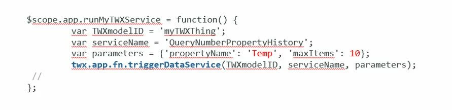

I have couple of question's about executing Thingworx Service in Vuforia Studio
  1. How to execute service based on data change / change in current selected item.
  2. How to execute service when view changes from one view to another
  3. And to execute service when popup widget opened/showed
Could any one help me with this.

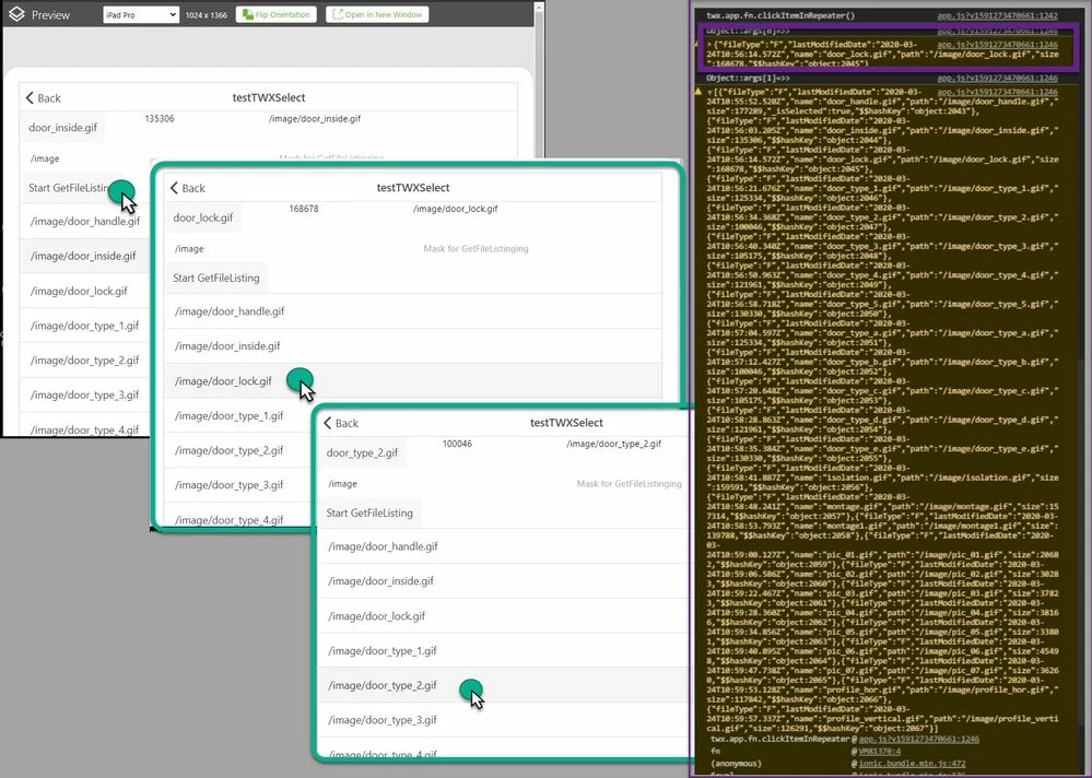

1.) e.g. for a list widget for example we can use the twx.app.fn.clickItemInRepeater e.g. in the example:
// when defined this function it deactivate the events:
// Current Selected Item
function isThisAnObj(val) {
 if (val === null) { return false;}
 return ( (typeof val === 'function') || (typeof val === 'object') );
twx.app.fn.clickItemInRepeater = function()
 console.log("twx.app.fn.clickItemInRepeater()");
 const args = Array.from(arguments);
for(i=0;i < args.length; i++)
 { if( isThisAnObj(args[i]) )
 		{console.log("Object::args["+i+"]=>>"); console.warn(JSON.stringify(args[i]));}
 else
 		{console.log("primitive::args["+i+"]=>>"); console.warn(args[i]);}
this code will detect in the args[0} the  data set which is currently selected -e.g. the print:
app.js?v1591308482832:1260 Object::args[0]=>>
app.js?v1591308482832:1260 {"fileType":"F","lastModifiedDate":"2020-03-24T10:56:40.340Z","name":"door_type_3.gif","path":"/image/door_type_3.gif","size":105175,"$$hashKey":"object:2034"}
2.) when we use the twx.app.fn.clickItemInRepeater , means when we define the callback in the JavaScript section - in this case this seems to DEACTIVATE the selection events on the widgets !!!  " Current Selected Item" for  the service is not working any more. When we comment the callback then it works again!

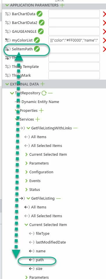

3.) When we use a property/item   of  the   Current Selected Item  section of  a service  - means   we  do not have a definition of the callback twx.app.fn.clickItemInRepeater  in javascript  - in this case we can link a item as mention in the previous post to an parameter and use a $watch angular construct
and  the code e.g. :
$scope.$watch("app.params['SelItemPath']", function (newValue, oldValue, scope) {

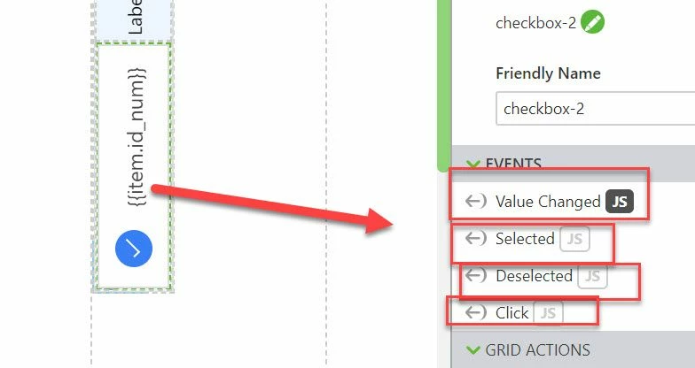

1.) It depends on what item you did change for example checkbox widget:
you have the events " Value Changed", Slected, deselected or clicked . You can use an event here to call a function which will call the service with some call like:

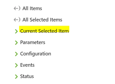

1.  I'm looking for selected item change event in Thingworx service
And also when I set Auto Select first row, I'm getting null values only.
/VR

That what you are asking, I believe, it is not about a thingworx event but this is an event based on the twx data which has binding   to a particular Studio widget. That is the event which based on the selection in UI when selecting an item of  the widget. So, when a service does not have binding you will see that this element are empty / or do not have any values
So the question here is how to track the event / the select on the Studio side

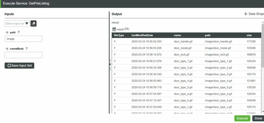

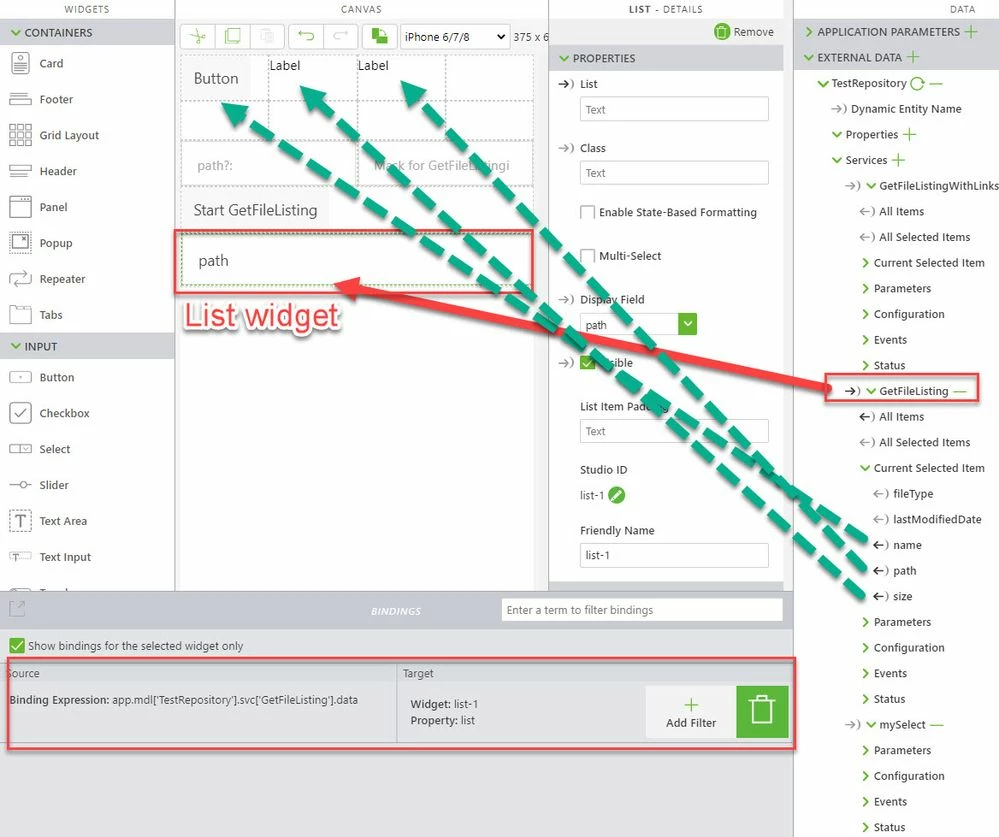

Let consider here an example with the service GetFileListing (Repository Thing) :
So, we can bind the service e.g. all Items - to a list property in a list widget and the different selected items to another widget / to the text properties:
When  we test it we will get on select the value in the different widgets as shown:

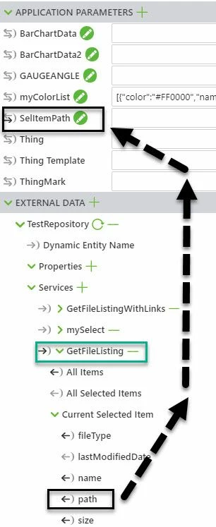

One possible thing is to read simple these values also in case if they are not visible. Possible is to bind them to an parameter ( or you can bind directly the Current selected Item of service to an application parameter and track the parameter change via the $watch construct:

 But of course you can use the twx.app.fn.clickItemInRepeater() callback what you can defined in the javaScript of the view (e.g. Home.js). When we click on the item the sample function will print to the console as shown in the picture above
 { if( isObject(args[i]) )
 else
Here the first argument (args[0] ) contains as object (json) the selected data set
