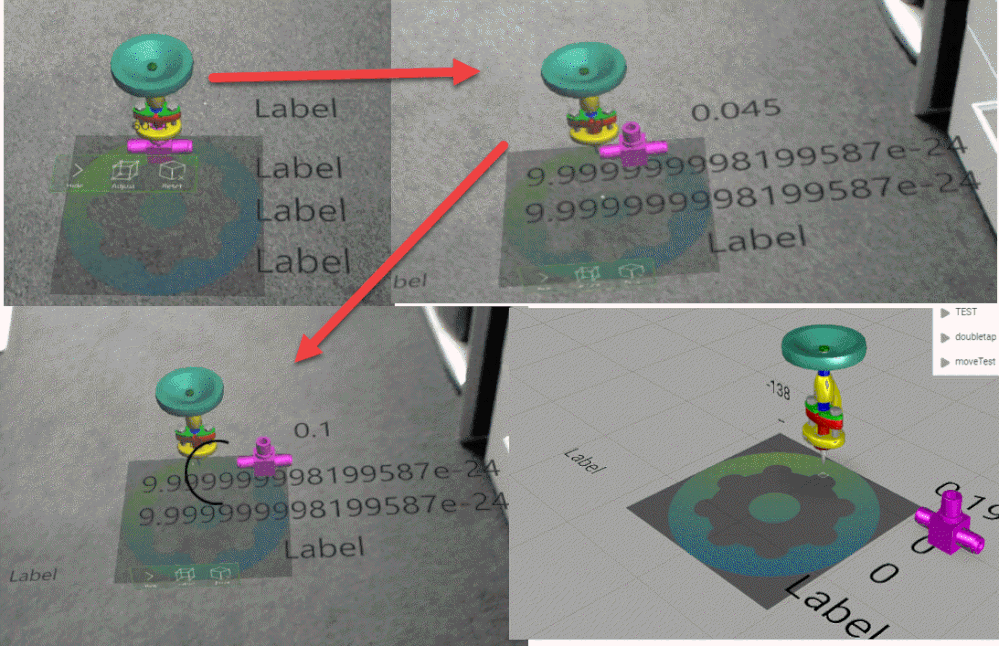

1.)The first question it is possible to extract model data of 3d models in Vuforia Studio?
In this case we have a model widget with an assembly model without explicit modelitem  widget definitions. The question is if we can extract data for the components and if yes then what data we can extract.

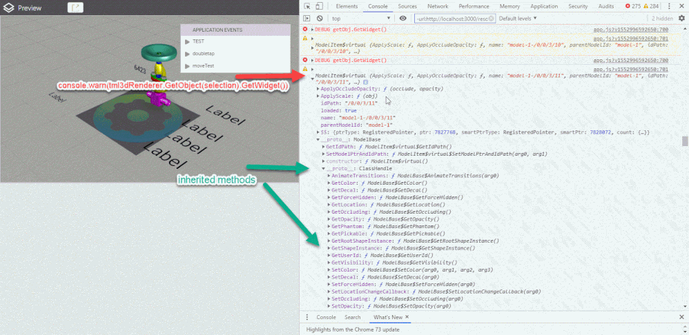

Extracting of data is possible only in Preview mode. So we have in preview mode the method tml3dRenderer.GetObject() where we can access an model object (an component) example:
let comp_widget=tml3dRenderer.GetObject(selection).GetWidget()
where selection is some thing like "<modelname>-<compPath>" e.g. : "model-1-/0/0/3/2"
Then from the widget we can extract data:
 var loc=tml3dRenderer.GetObject(selection).GetWidget().GetLocation()
 console.error("DEBUG getObj.GetWidget()")
 console.warn(tml3dRenderer.GetObject(selection).GetWidget())
When we   explore there the different methods we will find methods to  get or set properties. To extract data, we can use the get... methods.
The methods tml3dRenderer.GetObject() seems currently not to work in Vuforia View on end devices so that we will not able for example to get the data of a component selection. So means we need a way to extract data in Preview mode and make it available in the Vuforia view on the end device. Here I did not find a methods to extract the original component name but I was able to create a list (json) with the position data ( I did not add color but this is possible e.g. tml3dRenderer.GetObject(selection).GetWidget().GetColor())

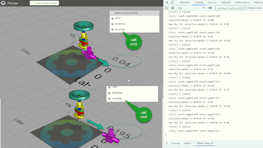

So later we can on end device read the current position data:
var selection_location=$scope.COMP_LOCs[l_currentSelection]
//read the location data from json varible console.log("selection:"+l_currentSelection+"->X= "+ selection_location.position.x);
//print it to console selection_location.position.x= round(parseFloat(selection_location.position.x) + 0.005,4)
//add 0.005 shift and round to 4 dec

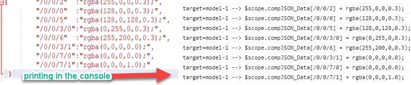

With the current functionality  we can read a file (json file ) from the project  upload directory , but it seems not to be possible to save and information to a file there.
To read a json file form the upload folder we can use some code like this:
target='model-1'
$http.get('app/resources/Uploaded/' + jsonFile).success(function(data, status, headers, config) { $scope.compJSON_mod=data; // in this case the data is the received json object
angular.forEach(data , function(color, path_id){ $scope.compJSON_Data[path_id] =position; console.log("target="+target+" --> $scope.compJSON_Data["+path_id+"] = "+$scope.compJSON_Data[path_id]); });//end of the error function ////////// finish for each path_id }) .error(function(data, status, headers, config) {console.log("problem in the http will create a new ");

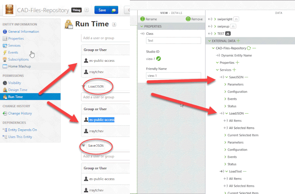

When we want to save data  (the generated json list) we need to use another workaround - we can use an thingworx repository. Following functions /events could be used to save and receive an json object to/from a twx repository:
// the methods SaveJSON and LoadJSON
// for the repository object should have

In  the code above I use the 'modelloaded' listener to register LoadJSON-complete event . Because the service is called asyncronously- we need this event to load the data into session when it is received from thingworx.
Here in this example the repository object is named "CAD-Files-Repository"
The Thingworx services should have run permission and it is required to be added in the external data panel :
So when we start the project in PREVIEW mode we can call the search for the assembly structure and save it then  to thingworx. In Vuforia View mode   then we can received json object from thingworx.

I tested all points of  the described techniques above in a project which I want to provide here as zip file for the HoloLens (hideComponetsHoloLens .zip):
So to be able to test it you need to create in Thingworx a repository thing - means a thing which uses  the thing template "FileRepositroy" with the name "CAD-Files-Repository" and create a folder there "/CADFiles/json_lists/" (if you use another name and another folder (e.g. "/" no folder - the root repository folder) you have to adapt the javaScript code:
/CADFiles/json_lists/compJSON_loc_Data.json
app.mdl.CAD-Files-Repository.svc.SaveJSON'
app.mdl.CAD-Files-Repository.svc.LoadJSON'
