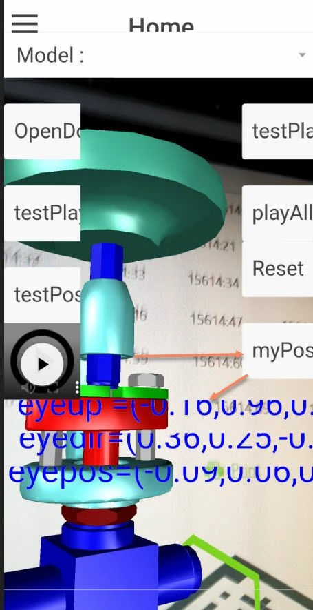

How to get camera position?
Does exist any syntax how to obtain the position of the camera in front of default coordinate system?
For example: A function which returns the position x, y, z and vector with camera orientation.
I will use this functionality to reorient and zoom to a small location on 3Dmodel, where will be played a sequence.
Thank you for every tip.

So I checked it further and  infact it is possible to  find t(trackerId, position, gaze -eyedir vector, up -eyeup) of the mobile device . In this case we have to use the tml3dRenderer.setupTrackingEventsCommand()   with callback which will for example write the value into some global variables or parameters.  The funciton definition should be some thing like:
ml3dRenderer.setupTrackingEventsCommand (function(target,eyepos,eyedir,eyeup) {
//setting the values to variable
 $scope.myPosition.target= target;
 $scope.myPosition.eyepos= eyepos;
 $scope.myPosition.eyedir= eyedir;
 $scope.myPosition.eyeup=eyeup;
},undefined);
I tested it on  android samsung s9 and it was working fine. I used the following relvant code to test:
tml3dRenderer.setupTrackingEventsCommand (function(target,eyepos,eyedir,eyeup) {
 // set values to a applicaiton parameter as string
 $scope.app.params['eyepos']="eyepos=("+eyepos[0].toFixed(2)+","+eyepos[1].toFixed(2)+","+eyepos[2].toFixed(2)+")";
 $scope.app.params['eyedir']="eyedir=("+eyedir[0].toFixed(2)+","+eyedir[1].toFixed(2)+","+eyedir[2].toFixed(2)+")";
 $scope.app.params['eyeup'] ="eyeup =("+ eyeup[0].toFixed(2)+","+ eyeup[1].toFixed(2)+","+ eyeup[2].toFixed(2)+")";
},undefined);
// function which is called by button
$scope.myTestFunction=function(){
//set the value of some 3dLabels Widget
 $scope.view.wdg['3DLabel-1']['text']=$scope.app.params['eyepos'];
 $scope.view.wdg['3DLabel-2']['text']=$scope.app.params['eyedir'];
 $scope.view.wdg['3DLabel-3']['text']=$scope.app.params['eyeup'];
So the a example above will update on button click the value of 3d labels according to the current cammera postion. (the problem of the text display on this picture is based on the too large font setting on my mobile device )

Jul 9, 2018 1:19 PM UTC
Hello  @RolandRaytchev,
thank you for awesome solution!
It works great.
PS: Where did you find this solution? Does exist some documentation about this functions and syntax?
