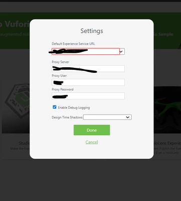

After you start Vuforia Studio, you can author experience project vial  http://localhost:3000/home in Chrome or Edge.
If Vuforia Studio is on the same machine as Vuforia Experience Service (VES), you can set the URL of VES as below:
http(s)://localhost:2019
If "nossl" is set to true in configuration.json, here the protocol should be http, otherwise, it is https.
If Vuforia Studio is on a different machine, you can set the URL of VES as below:
http(s)://<IP address of the machine LP-PFIAX4nk>:2019
then, after you enter the project name and URL of VES, the Create button should become active and you will be able to create experiences.

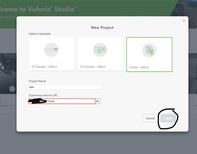

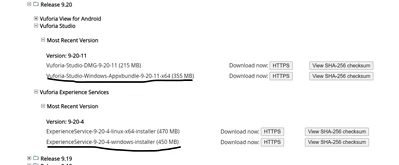

Jul 30, 2024 4:57 AM UTC
i have installed following bundle. vuforia studio 9.20.11 and vuforia experience server 9.20
Now while creating project  experience url was not taking by default , then i have added manually there but still this create button is not enabled here.
can anyone help me , how to proceed in this

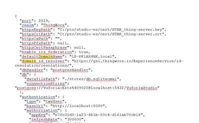

Sep 2, 2024 8:49 AM UTC
The format of Experience Service URL should be something like:
http://localhost:2019
Otherwise, the "Create" button will not be active.
To find the URL of your Experience Service, you can check the value setting of “defaultDomainName” and “port” in configuration.json under your Experience Service Installation folder <Vuforia ES Installation>.
Sep 2, 2024 10:15 AM UTC

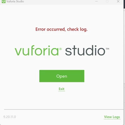

first of all after clicking open button of Vuforia studio
Url is opened is this http://localhost:3000/home
and as u said in configuration.json file i m seeing url is different
Can you please help me to proceed in this?
