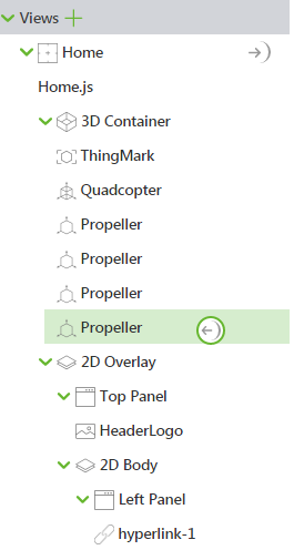

Hello all,
I would like to show and hide a part (in a model) when I click on a checkbox, how to do that ?

Selected is an event and it is supposed to bind with services, besides that, you can also directly bind the value property (of checkbox) to modelItem and in the pop-up you can select invisible.
Yes it is possible to put a name on the part. Also, the drag-n-drop can be targeted to the name of the model-item in the left-panel, as shown below:

Apr 5, 2017 2:58 PM UTC
You can drag a Model-Item on the desired part and bind the checkbox click to the Model-item's invisible property.
Let me know if that works.

Apr 5, 2017 3:06 PM UTC
When I am on the properties of the checkbox, and I drag the "Selected" value on the model-item, only services appears, how to bind to invisibility ?
Is that possible to put a name on the part instead a drag and drop, if the part is very small, it can be hard to find it.

Apr 5, 2017 3:15 PM UTC
