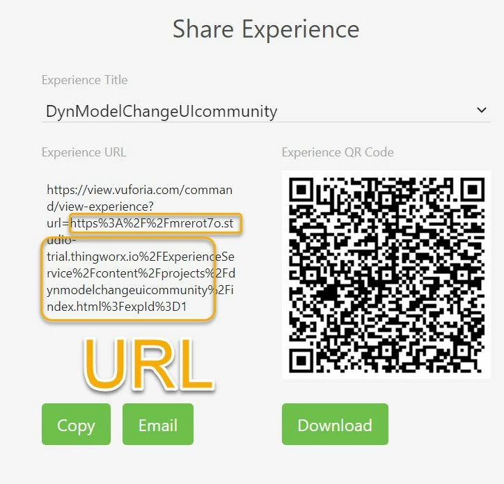

Hi Dear PTC Community,
Please, advise how to link the button within one project to the view within another project..
I assume it is a Javascript command but need some instructions,
Thank you
Jun 29, 2023 2:26 PM UTC
Hi @IB_10645210 ,
lets suppose that we have:
1.) Vuforia Studio Project "A" where in a any View there is button which should call:
2.) Experience "B" - which have e.g. Home as start view and also the Views TEST1, TEST2 and TEST3  etc
and we want that we have to specify in the call that view TEST2 in B is called.
I think is possible
In project A we have to define the function:
//url of the deepLink of Project B
$scope.UriTest='https%3A%2F%2Fmrerot7o.studio-trial.thingworx.io%2FExperienceService%2Fcontent%2Fprojects%2Fdynmodelchangeuicommunity%2Findex.html%3FexpId%3D1'
// the view of the proejct B which should be called
$scope.cVIEW="TEST2"
// this the function what should be called by the button
//it will call project B (specified by url - and then call view
$scope.callViewProject=function(url,view){
window.location.href='vuforiaview://ptc.com/command/view-experience?url='+url+'%3FVIEW%3D'+view
$scope.TEST1=()=> {
$scope.callViewProject($scope.UriTest,$scope.cVIEW)
This should be the call from Project A to B where we pass also as parameter the View which should be called here 'TEST2'
E.g. the URL we can take from the deep Link  of "B" in the Share Tab Share Experience
So that is the part what we need to call from project A to call B->TEST2

Jun 29, 2023 2:30 PM UTC
But we need also to handle the parameter in B when Project B is called then we need to check what of argument was passed to it.
Let say the Home view is the start view. Then we need in Home view to check the passed parameters and then navigate to the View which was passed e.g. TEST2
I used some code like this what I verified that worked on Android planform:
//////////////////////////// CODE ADDED to start View e.g. Home.js
$scope.$on('$ionicView.afterEnter', function() {
//checking of parameters
 $scope.app.params.CurrentURL = window.location.href;
 let str=$scope.app.params.CurrentURL
 const words = str.split('VIEW=');
 if(words.length >1)
 let next_words=words[1].split('#/')
 console.log(next_words[0]);
 let view= next_words[0]
 $timeout( ()=>{
 twx.app.fn.addSnackbarMessage("VIEW="+view,"twLogo");
 $scope.navigate(view)},100)
//---------------------view Enter End
