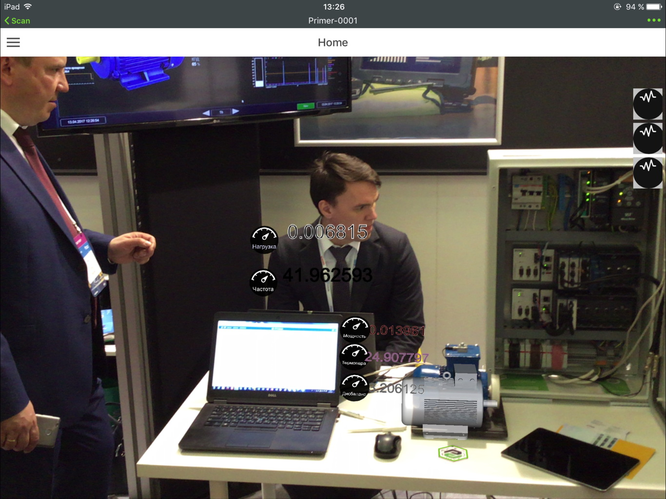

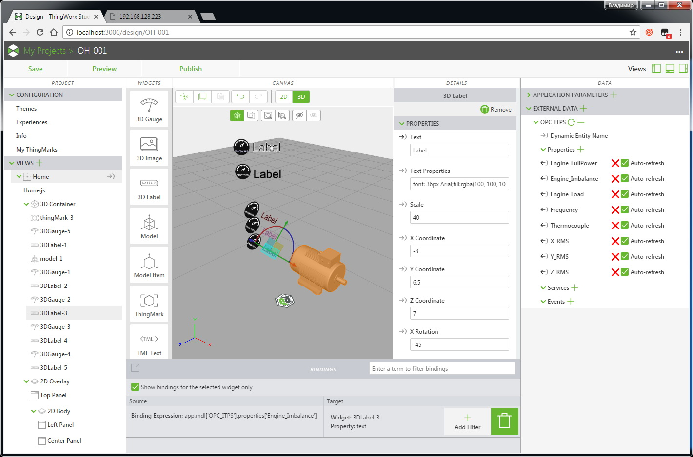

Regarding my experienses: I use iPAD and method one  (as described above) and made dozens of snaps for demonstration AR cases:
example 1 - prepare the AR model with widgetes and labels:

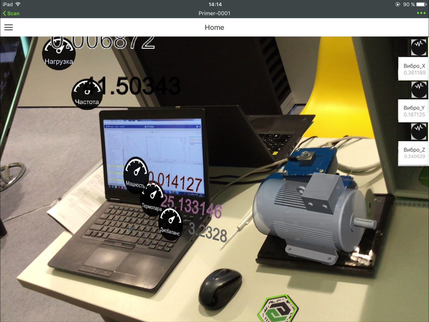

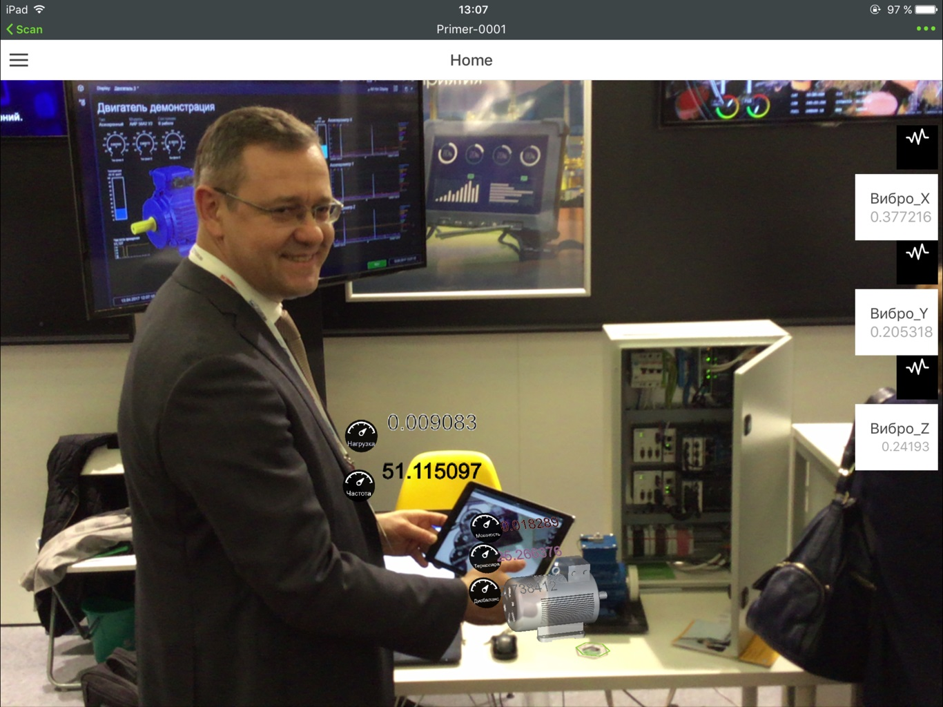

Then use it in the real device and fix AR presence in iPAD as a snapshots according method one above:
(You can see all three pictures are snaps from iPAD screen in ThingWorx View)
