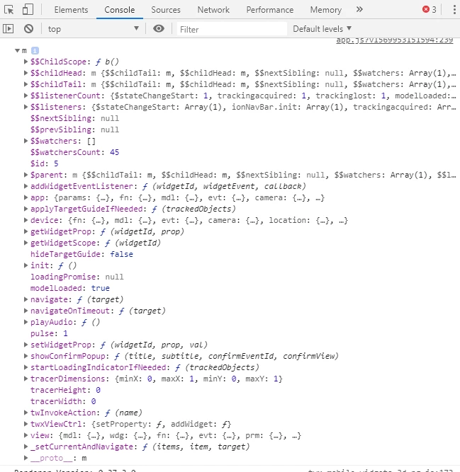

Kind of a multi-part question. I have added a 2D audio widget ('audio-1') into my project. I would like to have it start playing only when I touch a 3D image.
1) How would I go about implementing this? I've been having issues figuring out the code and the path name to reach this. Is it $scope.app.params? Is it $scope.app.fn.triggerWidgetService('audio-1', 'playAll');?
2) Just in general, can someone help me understand better all the pathnames? It's kind of a pain trying to figure out what works and what doesn't. Likewise it's hard to figure out how to have the code trigger events like animations of .pvz files (svc.playAll for example). If someone can kind of type them out and/or help me understand how to derive these things, it would help immensely. Loosely I understand the bindings that the UI provides, but it's still a little confusing trying to actually type in the line of code that's syntactically correct to do what I need it to do.

For finding the possible services/events, try exploring the $scope object within the browser console window. You can navigate through the object within the console by adding console.log($scope); to your Home.js file.
