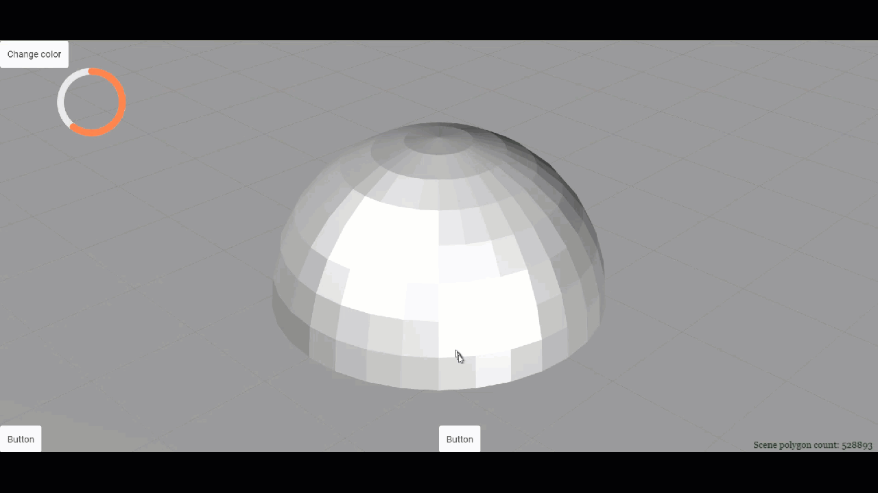

could you provide , please, an example where you have an issue with the back facing polygons According a definition  in

currently there is no supported way to have direct change of the  OpenGL  setting , so that this is valid change for preview mode but also for the mobile devices. The option what we have to use GLSL for preview and mobile or HLSL for the HoloLens device is to use vertex and fragment shaders. When we use a GLSL no all openGL variable are passed to the shader. Also the outputsof the shaders will effect only few openGL variables like gl_Position (past to the fragment shader) and gl_FragColor (result of the display)  variable are passed to the shaders and also few variable could be changed by the shaders
We can apply shaders to any widget to change the display of them. Or try to optimize the display (the current shader is already a good optimization so far) or to change the display showing some feature like medium flow, gradients etc.  Also  default widget shaders used in Studio ,so far I know will not  display any tessellated surfaces , therefore in the normal case we do not have the requirement to perform extra face culling
Therefore it will be interesting to know why do you need extra setting of back facing culling, or with other words where do you have an issue where this causes Problems with the display? Thanks

I add  if(gl_FrontFacing){ discard;}   in fragment shaders  to make frontfacing polygons are automatically culled .
gl_FrontFacing — indicates whether a primitive is front or back facing
The application scenario is the operating room, surrounded by walls, and the user needs to see the inside of the operating room without being blocked by the wall.
Oct 25, 2021 3:33 PM UTC
Yes, when the gl_FrontFacing is passed to the fragment shader , then is no issue to  use it. Otherwise, you can use some space coordinate to discard the display or to switch to a transparent shader
