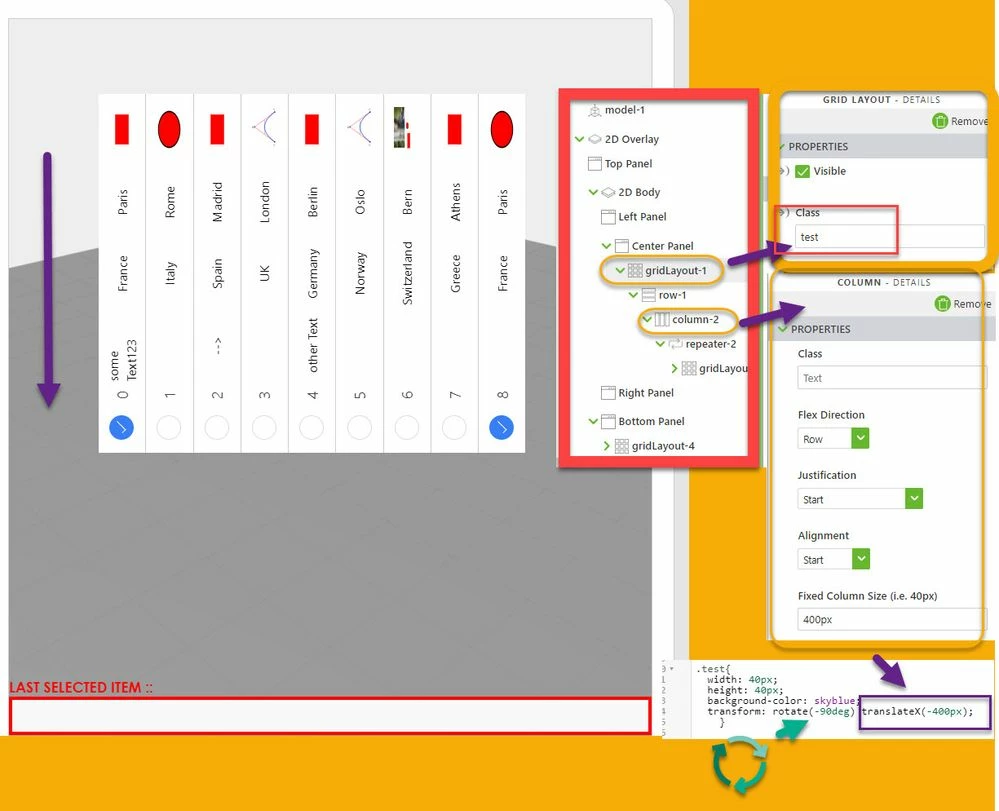

it seems that we can not achieve this only with property settings but possibly in combination with css style definitions - e.g. in the Applicaiton tab:
.test{
 width: 40px;
 height: 40px;
 background-color: skyblue;
 transform: rotate(-90deg) translateX(-400px);
And we can set the test to the gridLayout which contain the repeater (will rotate and translate it) . The best value could be found after some tests.
For quick test I did have the following appearance:
Of course, you can use some rotation also in sub elements e.g. repeater cells - for example you can rotate back the text again 90 degree if you want to have a horizontal texts but it will definitely require a number of tests when you want to achieve the desired appearance of your layout.

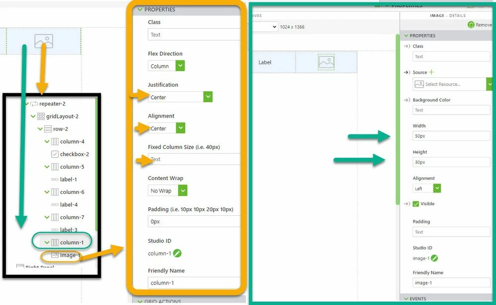

Hi  @Velkumar ,
to be sure what is the issue, could you please , provide more detailed description.
For the repeat widget -what is the source, means where did you get the data/ or how did you generate it? Or do you want to generate the data?
So I believe the data is not complete? Rights. -may be  here will be a picture helpful  or sample of the data (json ) will give more clarity,
What is the goal and the reason when you want to fill data?
Velkumar19-TanzaniteAuthor
May 29, 2020 9:25 AM UTC
Hi @RolandRaytchev
I have mapped and able to view data in repeater widget. PFB PNG for your reference
Currently data are filling from top to bottom. I'm looking for way to fill data from left to right and remaining data in bottom like Thingworx Collection widget and Repeater widget.
/VR
May 29, 2020 9:55 AM UTC
Thanks for clarification!
So when I correctly understand the problem - there is the problem that the picuture has not the correct size and are shown only partially? Right?
My impression is that here the problem is the format of the image widget. So to fix it you can set the property of the column and the widget image
but I see also you mentioned the order the data is written to the repeater? so you need the to write from left to right and from bottom to top.
