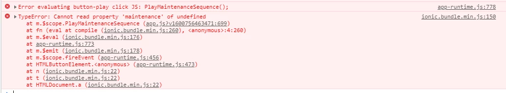

Sep 21, 2020 11:58 AM UTC
Thank you for your reply.
I tried your code but didn't work.
In the inspection tab appear the message into the screen above.
Any suggestions?
Thank you.
Sep 22, 2020 11:05 AM UTC
Hello Leonardosella,
I have updated code.
I did a bad copy and paste and I have missed to copy A into App instead of pp.
Added also $scope.$root.$broadcast who is needed.
Best regards,
Samuel
