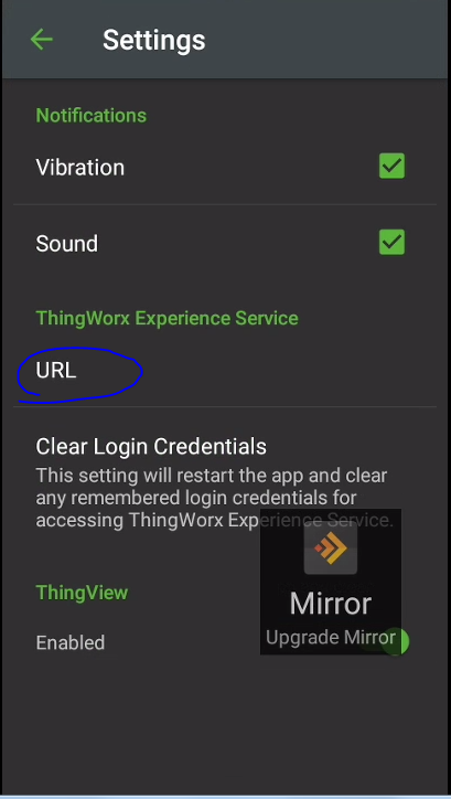

Hi all,
I am using trial version of ThingWorx Studio for 90 days.
When i publish experience i am able to see it with ThingWorx View just in the case i add thingworx experience service URL to thingworx view settings.
Is it possible to publish it to public, so i can see it even i do not add this URL?

Michal,
Yes it is possible for public view i.e., an user with ThingWorx View app can scan the ThingMark and view the associated Experience.
Also, we don't even need to add URL in the app settings. Please follow the Help center article on configuring Public Access to Experience projects and especially the Grant user permissions section.

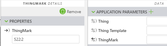

Sep 26, 2017 6:23 PM UTC
Hi Michal,
Everything looks correct from what you have shown. Do you have the ThingMark bound within the experience? Please make sure you have ThingMark 1262:2 listed in the ThingMark property within your experience. Below is an example from my experience using a different ThingMark.

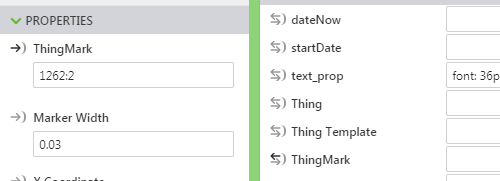

mhucik1-VisitorAuthor
Sep 27, 2017 5:52 AM UTC
Hi Tara,
First of all thank you for your interest and replay.
Yes i have it bounded. Look at the picture below
Michal
