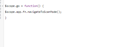

yes
you may have not seen the correct code :
So your function is incorrect.
its not app.fn ....
its $scope.app.fn...

One way to do it is the following:
that works - just validated it.

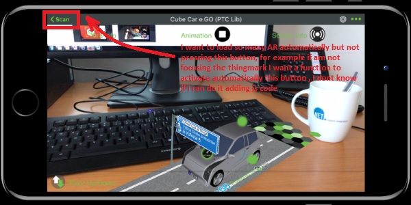

thank you very much for your help , maybe I was not so clear enough , let me explain you  what I want to do , I want to load so many AR experiences automatically not pressing the Scan button , for example if am NOT focusing the firts thingmark or if I lose the thingmark I would like to add a function to activate the Scan button automatically , not pressing the button js_issue.jpg

Well, I'm not sure if that is a reasonable way to do things.I wouldn't recommend it. You will loose the "real" AR capabilities with that specification.
With the way described above you would not be needed to use the scan button anymore.
I would most probably implement that function automatically, when the work is done / and being validated by the user (status written back into another system, via thingworx).

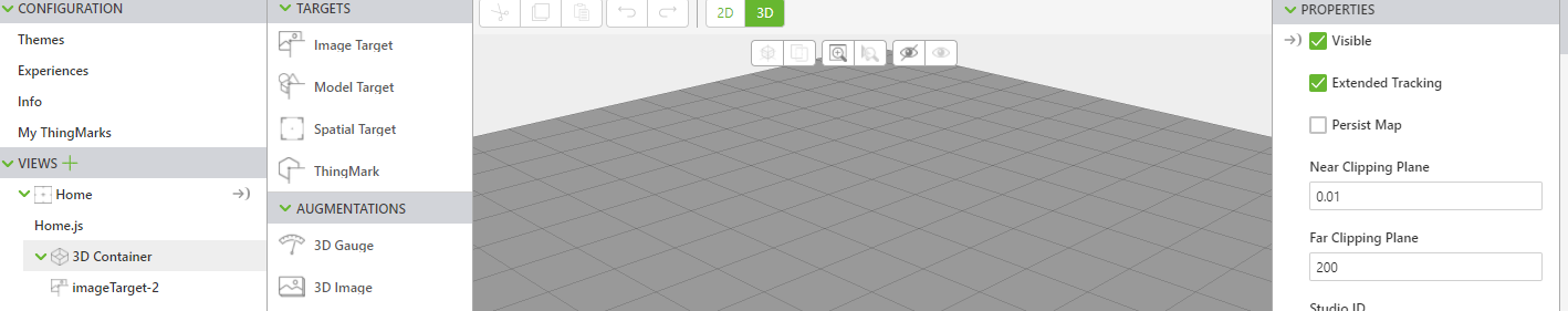

If you loose the thingmark, the extended tracking will jump in --> if you disable it, you won't be able to work without having the thingmark in sight.
(you can disable it with a checkmark inside studio).

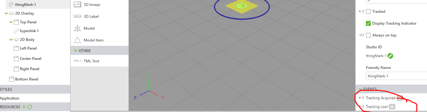

Disable the extended tracking. Then there is a function called "tracking lost" -> you can use that to trigger your scan function and you will have your wanted behavior
