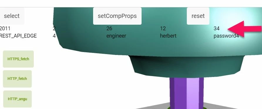

When I tested it my observation are that Https and http requests will work in Studio in preview mode.. But only the https request will work on both android and IOS devices. The http fetch request will not work ...
This means trying to design a solution which will call javaScript on the Vuforia view to read data will not work / or will not be stable.

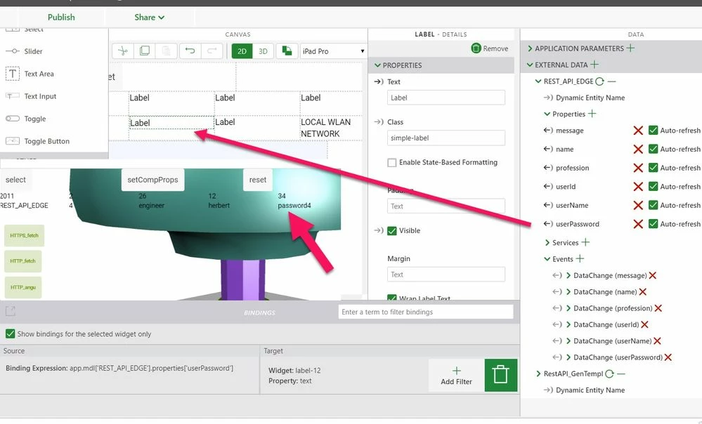

Therefore, the best way /also the supported way is to get data via the External DATA panel:

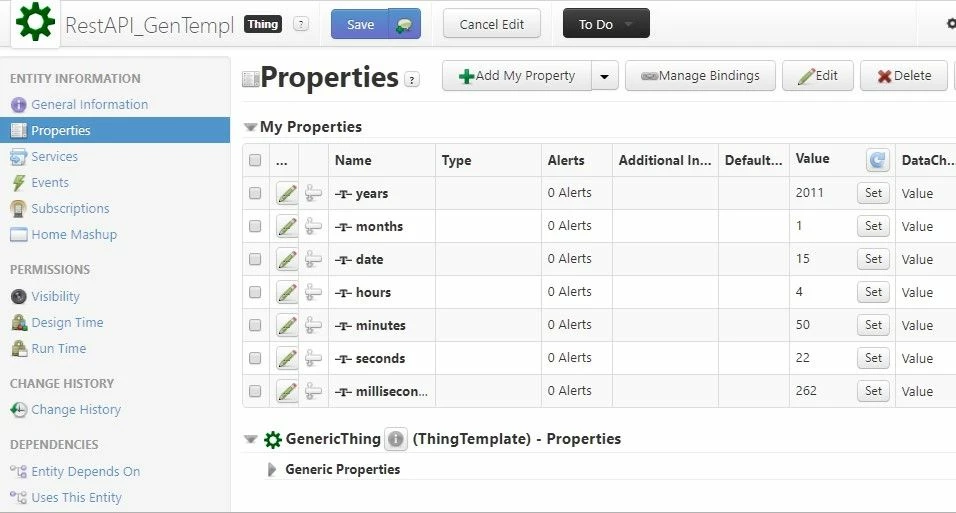

Here , we need first to create a Thing with properties which could be displayed in the experience project.
The next step is to read the sensors and update the properties.

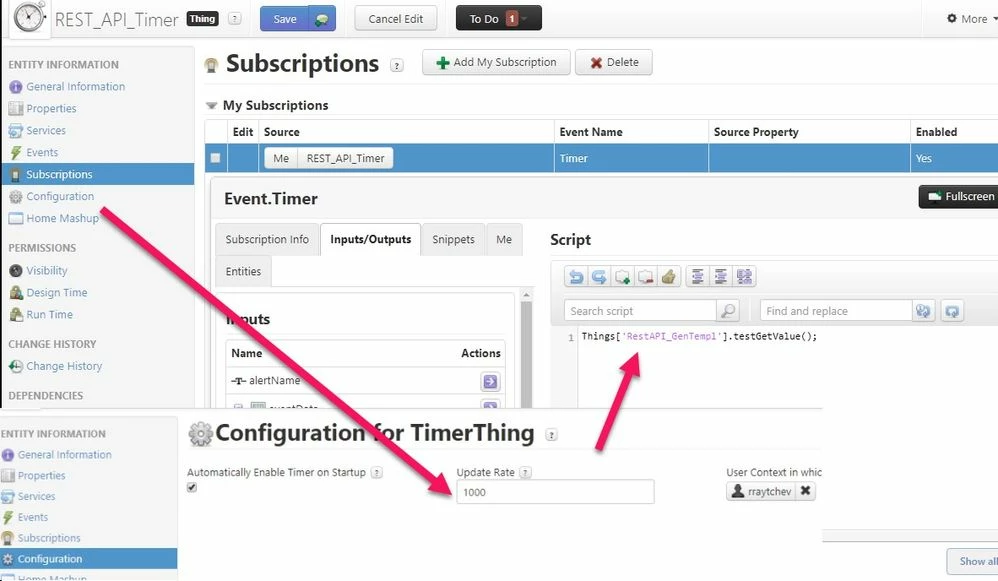

In case that we can see the sensors URLs from the thingworks instance / in this case we can use a thingworks service called by  a timer which will call in  particular interval  , so the service will  read then the  data from the sensors.

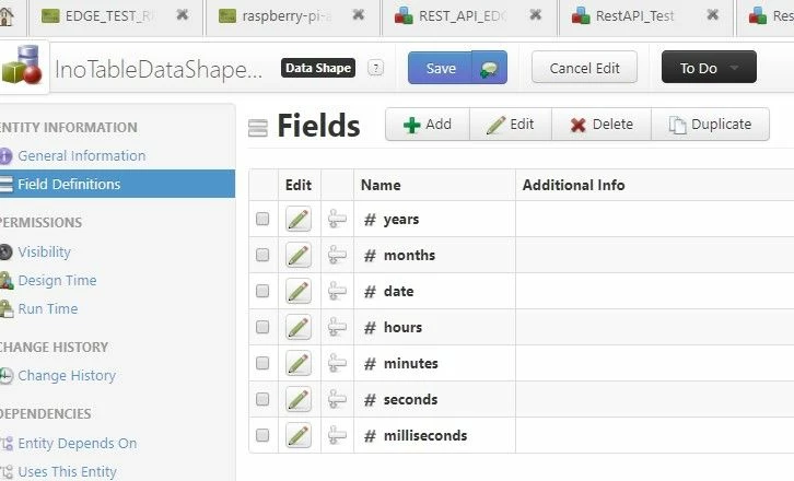

To be able to convert the json to a infotable we need here to define a datashape with the same fields corresponding to the json elements (here e.g  InoTableDataShape_Time1):
So every time when we call this service it will call the postman-echo web.side with some random data and will set the values of properties based on the received data  from the request. In this case the request return the sent data but here is important to demonstrate the principle how to call it.
Now we need to create a time which will call for interval (here 1 sec /1000msec) the service (here testGetValues) according the definition above.111114.jpg
his will update the values of the property and we can see them in Vuforia Studio.
