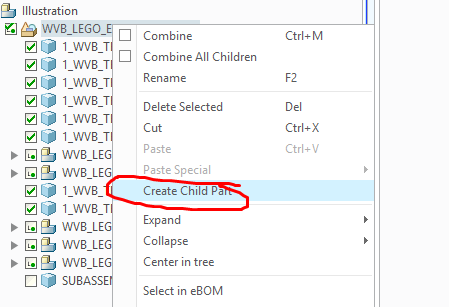

If it is an assembly that has no hirarchy in it - saying everything is on level 0 you could regroup things using Creo Illustrate "edit structure" function.
Thus you would gain hierarchy levels - like 0/1/  0/1/2 etc - resulting in component occurence IDs

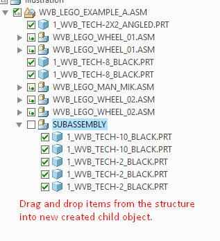

I already tried the Edit Structure Function and grouped / combined Parts out the the assembly. But I couldn't notice any change in TWX Studio for the model items. It also seems that an hierarchy already exists in the assembly at least a tree structure. I would appreciate any more detailed help to solve this issue.

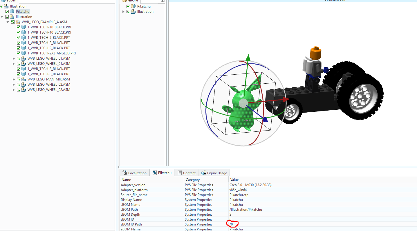

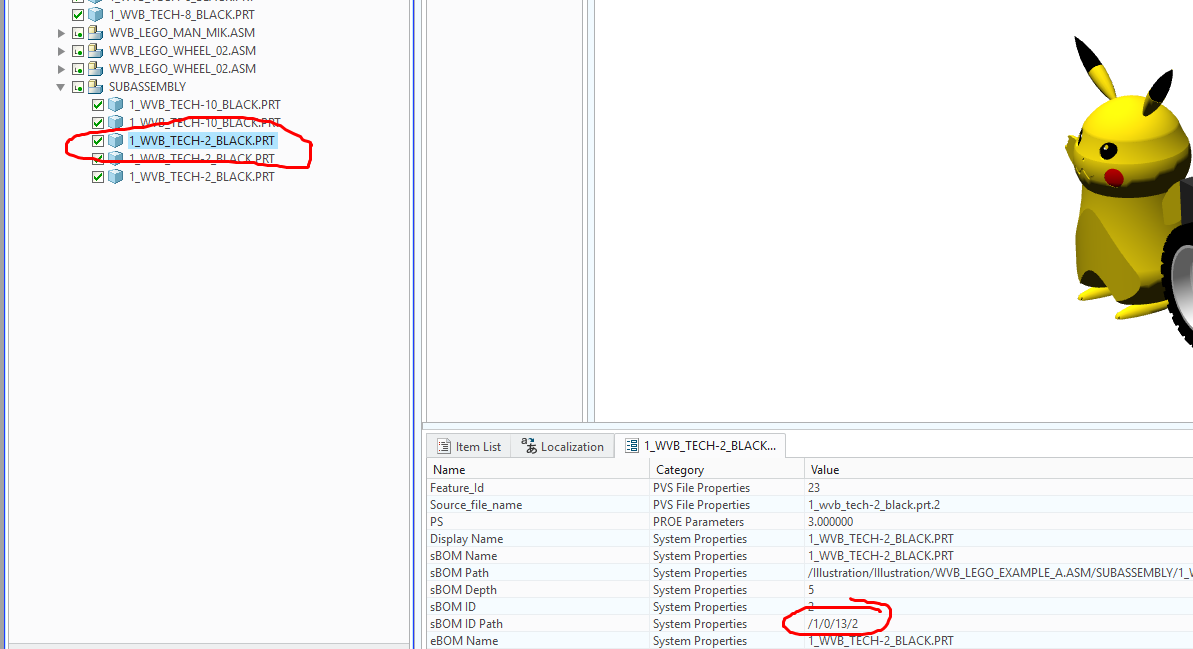

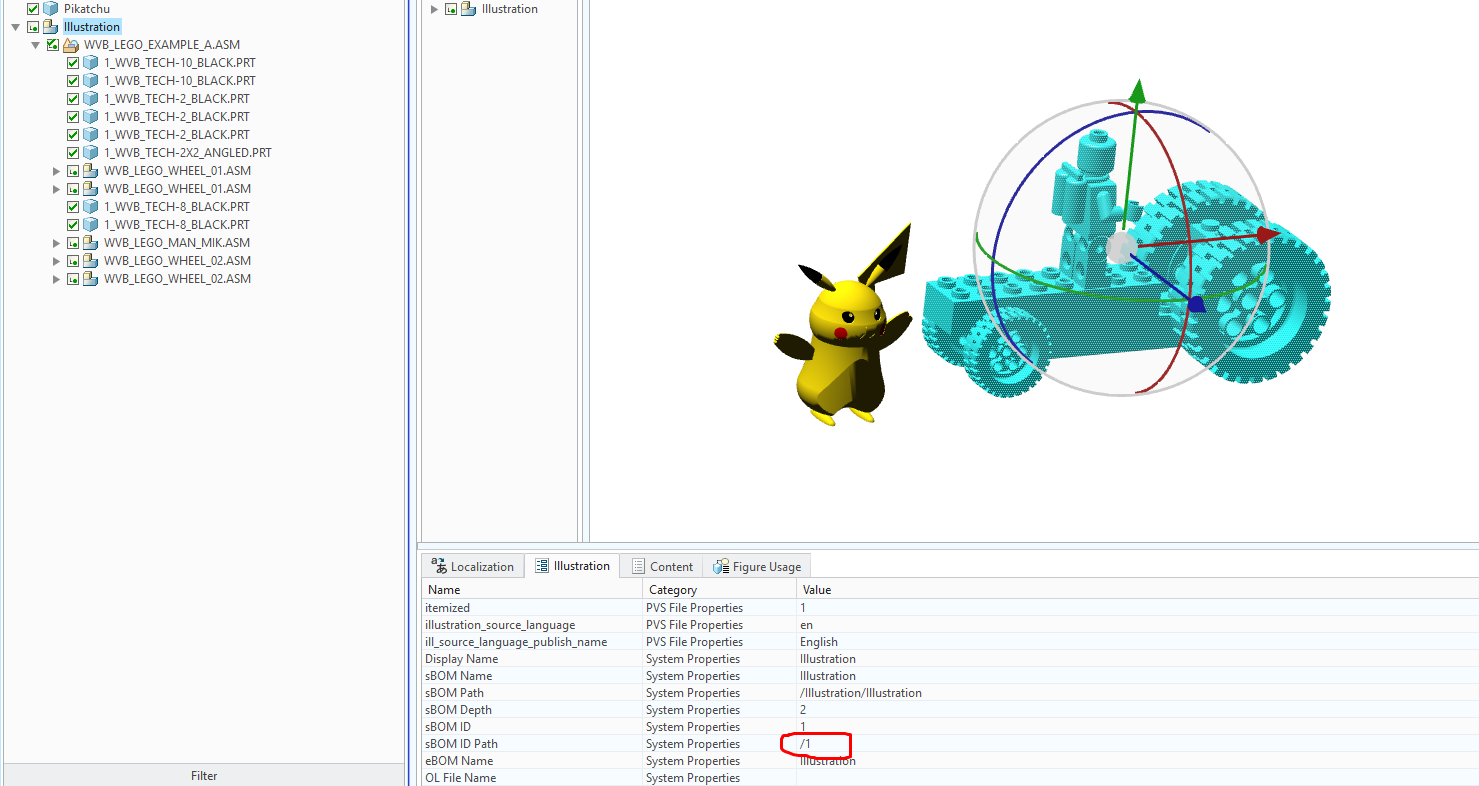

first you need to understand that each part in an assembly has a hierarchical ID - called sbom ID / or occurence ID.
below are three examples to display the concept of that.

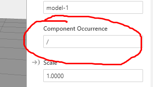

Those occurence IDs are reachable from thingworx studio. Which means when putting a model-item you can change the occurence ID of this item to the "wanted" item. (Be aware that positions in the room may change, when changing to items that are not belonging to the same root).
Whenever your model has those hierarchys and a good data quality and structure you can reuse that.
If that is not the case you need to regroup parts / create new sub assemblies as wanted.  All below.
Within Tools -> Edit Structure:
those items receive new sbom ids / occurence ids that can be used with modelitems in studio.
