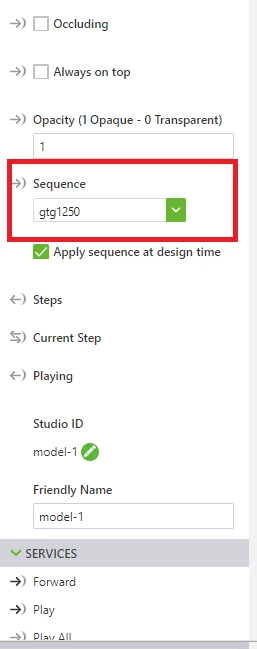

I have multiple sequence in a pvz file out of which I want to set a particular sequence as soon as the experience is started.
I tried setting the sequence as shown in the attached image but it is not working and the Hololens still loads the default sequence when the experience is triggered.
Also tried the below code to set the sequence and called it on model loaded event still it doe not set the sequence.

I also tried setting sequence as shown in the attached image but it is still not working.
