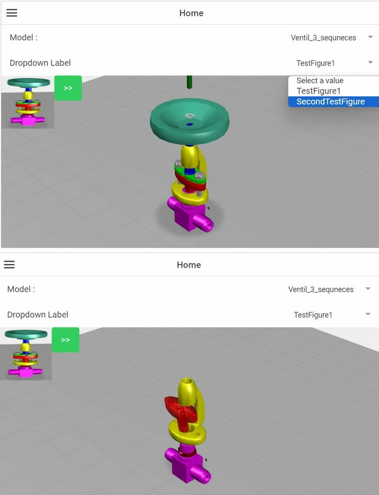

Please advise how I can place the sequence list to a dropdown list.

here is an example where I did test in the past some select widgets with a list e.g. sequences. So this sample project could  be a possible start point to discuss what is required in your case. Thanks

Take a look - "How can we show different steps in one sequence with different buttons?": https://community.ptc.com/t5/Vuforia-Studio/How-can-we-show-different-steps-in-one-sequence-with-different/td-p/596115
