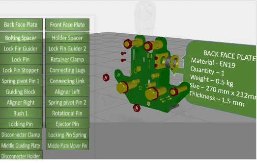

 I am playing sequence on one button ,after playing  if i am switching to another button to show my bom at that time my sequence model is still showing .
i want to deactivate the sequnce .

as i do not have a coder background so understanding the code was an issue ,
I have applied this code but it didnt worked .
my problem is -
after playing the sequence when i switch to bom the parts which are created as model item gets hide but my model does not get hide(in the model there are parts which i do not want to show in my bom).
