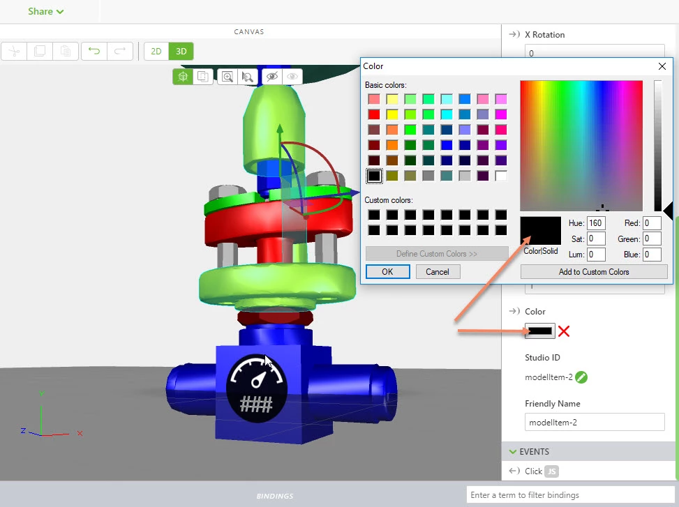

this should be possible with a restriction. There is a problem when the color is not set. So means when you set the color on your javascript code  to a value  example:
$scope.view.wdg['modelItem-2']['color'] = "rgba(255,0,255, 0.6)";
then you will be not able later to set it back to  the corresponding  name in the Vuforia Studio UI :"unset -X" or "Color|Solid"-

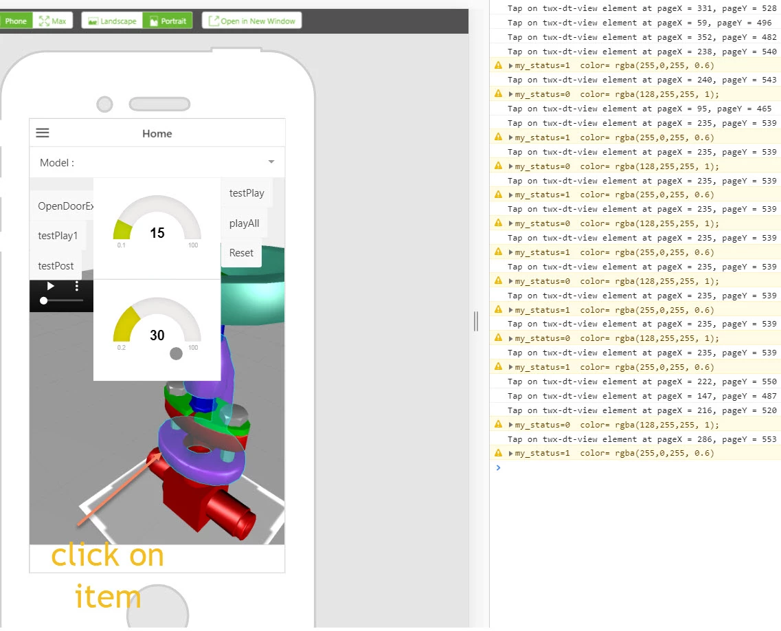

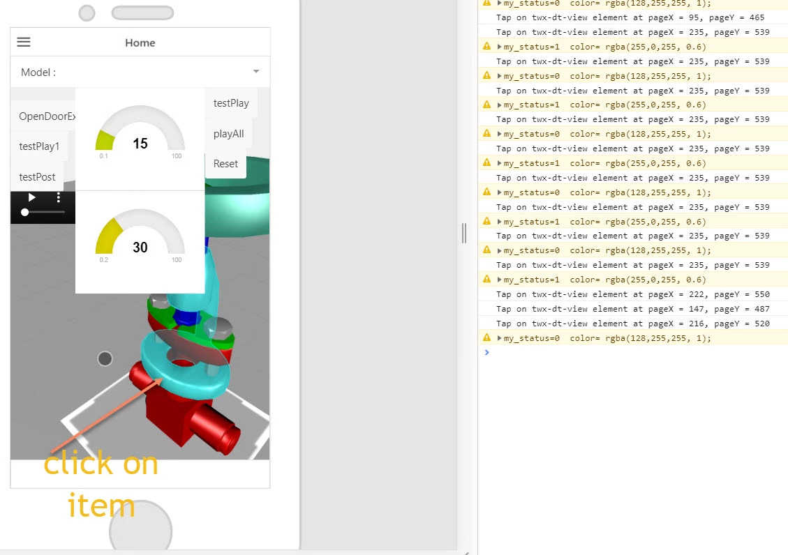

So I set the color property of specific model item and   defined a function which was applied of the click event of the modelitem .  Clicking on the model item will change now the color:
It will switch between old and new color
Here the whole relevant  code what I used to test the problem:

 console.warn("on begin my_status="+$scope.my_status+" color= "+$scope.view.wdg['modelItem-2']['color']);

 console.warn("my_status="+$scope.my_status+" color= "+$scope.view.wdg['modelItem-2']['color']);
