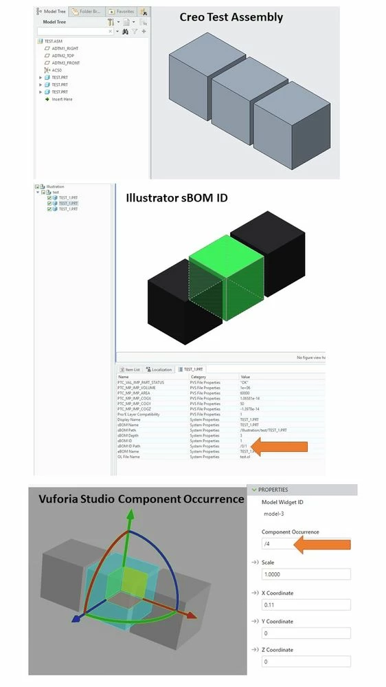

rhudd10-MarbleAuthor
January 16, 2020
Hi @RolandRaytchev
Thanks for your detailed reply, this makes a lot more sense now. I will use your first approach. 😊
The only thing I don't understand is what the Component Occurrence numbers in Vuforia Studio represent. They don't seem to reflect the sBOM ID Path parameter, as this PTC article suggests.
I've attached an example I just tried. The value is Illustrator makes sense, I don't see why Vuforia Studio isn't the same. Are you able to clarify this?
January 17, 2020
Hi @rhudd ,
thank you for your feedback!
Yes, I think this is a little confusing.
So let explain.
If you have Creo Parametric  assembly with 2 components TEST1 and TEST2
Let say the feature id /component Id in Creo Parametric is TEST1  12 and TEST2 is 19
In this case in Creo the Path Id is TEST1 -> /12 and  for TEST2 -> /19
I think if you save as pvz file this should be also mirrored in the BOM as we can see in Creo Parametric , but ....
when you open the pvz file in illustrate and create from there a Figure e.g. to define a sequence - this unfortunately will change the BOM and the component Path Id - often adding a preceding /0  for the root -Illustration and changing the Creo Feature/AsmCompPath id to some smaller numbesr
so that now the path there is
TEST1 pathId -> /0/1
TEST2 PathId -> /0/2
I just observed  that this will change the id. Did not check exact what is the logic behind this change.
So that in this case if we know the name of the parts and follow the sBOM Path example:
/Illustration/CAM_FOLLOWER.ASM/FOLLOWER.ASM/FOLLOWER.PRT
We can identify the correct corresponding component and recalculate it with some significant programming work
For example we can extract the bom in Creo Prametric with Creo Parametric TOOLKIT or via saving of the model tree as text
Then we can extract the bom from the pvz e.g. via Creo View Toolkit
A later we can compare the both trees and update e.g. Home.js. -> but this will requires as already mentioned  a significant amount of work to implement this approach
