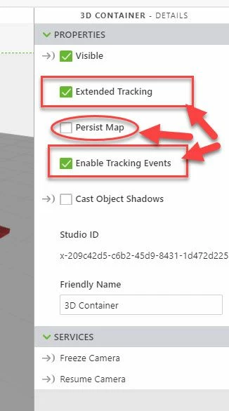

Supposing you have set in the  builder-setting.json -> "showTrackingEvents": true  - you will have in the UI for the 3D Container Widget the options (mobile project):
For the mobile project you can select then to make the tracking more stable. On the HoloLens you do not have all option but generally the tracking is more stable compared to the mobile devices
When you lose the tracking - the question is what then should happen - because loosing tracking means that the target is not any more persistent for studio and need new scan.

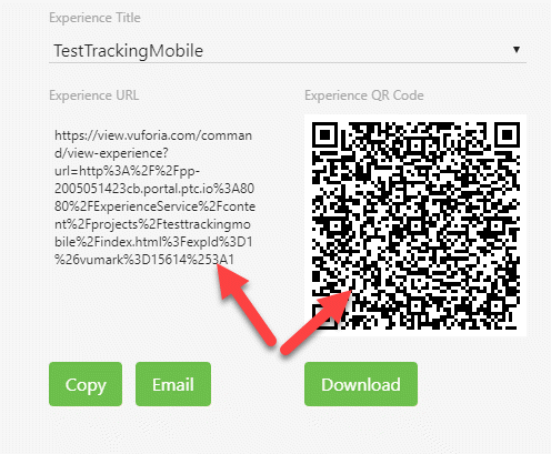

May 6, 2020 2:01 AM UTC
Hello RolandRaytchev
I'd like to explain my experience so my purpose may be cleared:
(We use ipad pro for our experience)
In Our experience, our space is quite huge so sometimes will encounter tracking shift, which result in the object position goes wrong.
So We think put two thingmark in different point would resolve this problem via reset tracking
and since vuforia studio not support two different thingmark as we know, we decide to use two same thingmark with different QRcode as solution. That's why I need "reset tracking" by javascript.
We already know how to handle event such as tracking acquire / lost, but cannot realize how to reset tracking by ourselve. All we study now just tell us the way to "rescan thingmark" and switch view.
thanks for your reply.
May 7, 2020 10:27 PM UTC
Hi @kobe04262002 ,
I think this an interesting point/scenario. I wanted to check it more detailed. I have an iPad 6 generation device and planned to check with it. But I need to understand it more detailed the workflow.
- how do you decide that the tracking should be reset? So far, I understand this should happened after user realizes that there is some unwanted shift / inaccurate positioning auf the augmentations objects? – Means action initiated by user? Which action did you use there?
You mention that you used “ same thingmark with different QRcode as solution“ that is for me not 100% clear. Because the QR code could be used as dummy picture ( not recommended action) inside a picture target or – what I believe here – you read the QR code as such. The QR is the same as you will call e.g. click the deep link and it should have the same effect – in this case you will call an experience via the deep link without scanning the experience – so it will automatically go in the start view (by default the Home view) and if there is target it will start scanning for this target.
