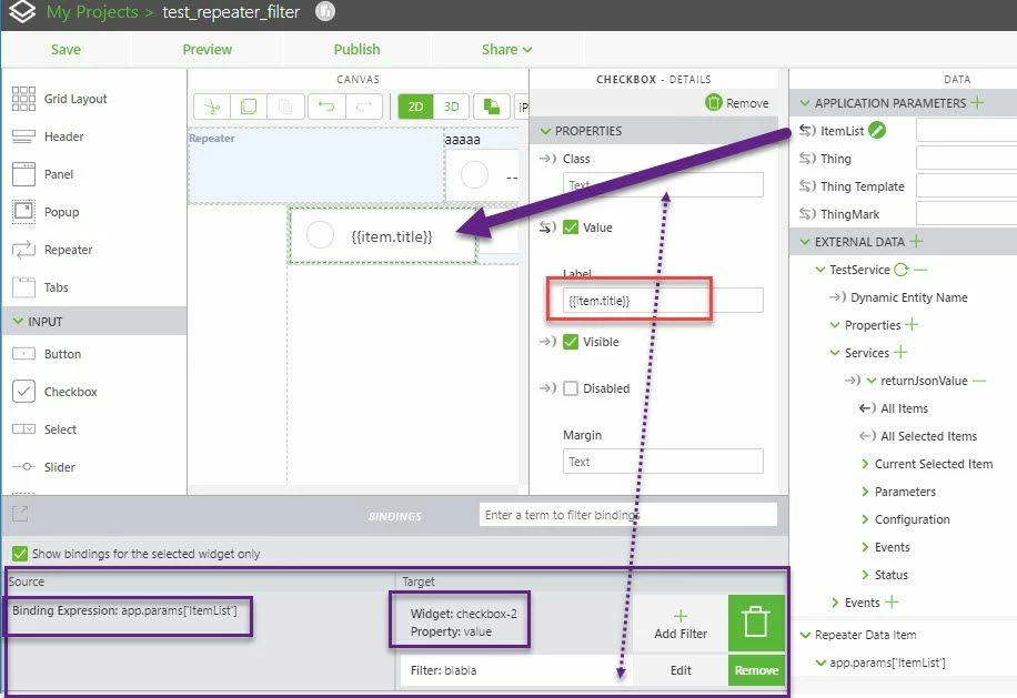

I made 2D Widget
Left Panel
 + repeater
   + checkbox
i bind ItemList to repeater
checkbox Label is {{item.title}}
it's well display title
i bind ItemList to checkbox Value
and How to write Add Filter?
Can I Change CheckBox Value By DataList
Filter Body
return (  HowToget( item.checked ) === true ? true : false )

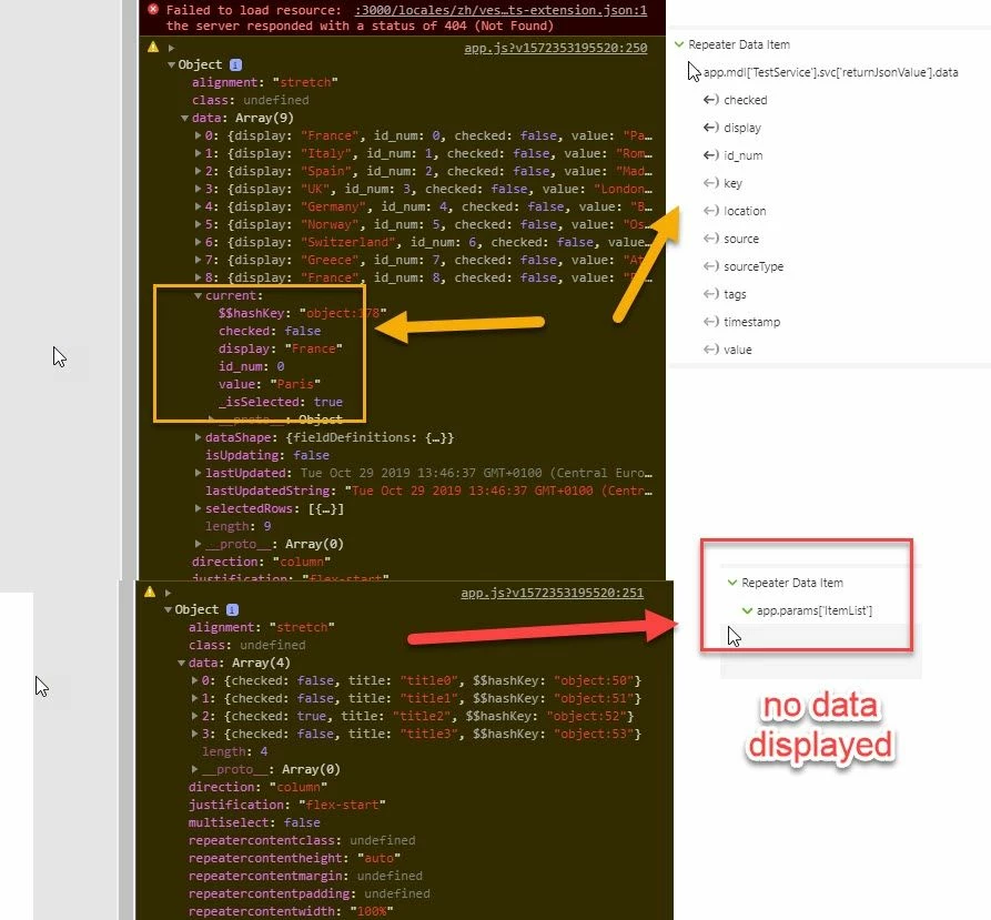

In your case you will set a list (array of json’s) directly to the repeater.
You can put in the text field of the label. {{item.<propertyName>}} where <propertyName> is the name of the field in the array that is to be displayed in the label.  In this case you will see the value in the field but unfortunately, I did not find a way to access this value on runtime when the table is created and also it was not possible to access this in a filter
The filter is text which is evaluated later in a filter function. The problem only the value is passed to the filter and there is no possible to access variables outside (e.g. $scope in not valid there)
For example I have an simple project with 2 repeater.
The one repeater with widget name “repeater-1” use a data from a TWX service
The second repeater used data from an app parameter (your example) containing a Jason list (array)
So when we  can see the difference:
$scope.$on('$ionicView.afterEnter', function() {
 $scope.app.params["ItemList"] = ItemList;
 console.warn($scope.view.wdg['repeater-1'])
 console.warn($scope.view.wdg['repeater-2'])
So in the one data set  we do not have an info about the current data set and could used it directly to assigneed a value to a repeater element.
Only the syntax  {{item.<propertyName>}} is working on the fly to to replace the text with a value of  a property when the repeat widget is displayed.

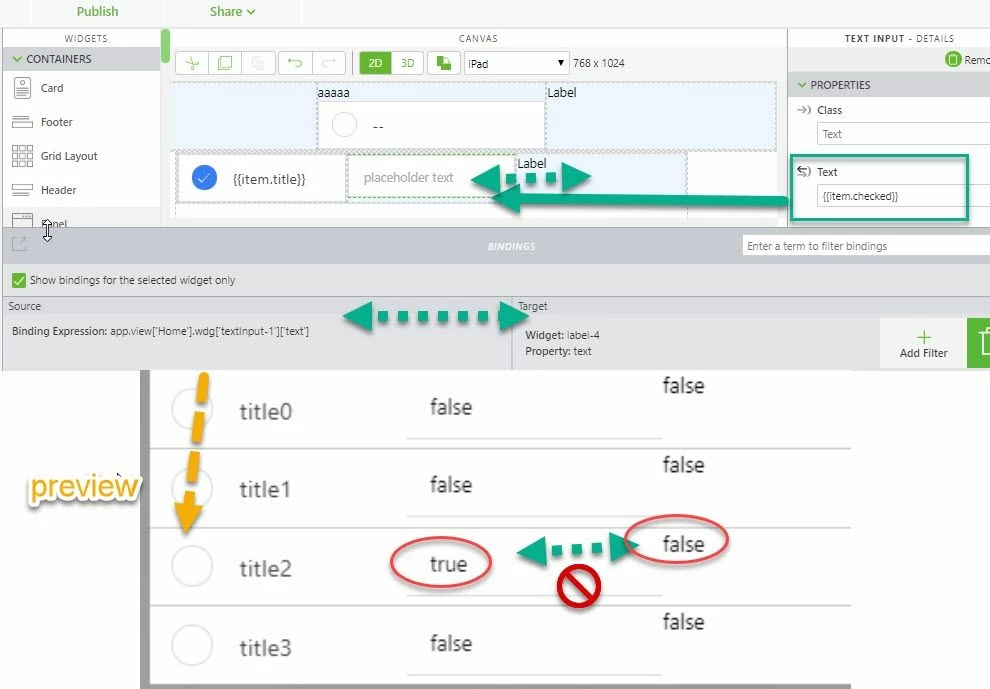

Unfortunately we can not use a syntax like:
val= $scope.view.wdg['repeater-1'].text;
or
let val= {{item.title}} ;
or
let val= item.title ;
and etc.
it always will lead to error. Also the $scope is not defined inside the filter.
Also if we try to use a binding of other field which is set using the syntax  {{item.<propertyName>}} - there is also no success:

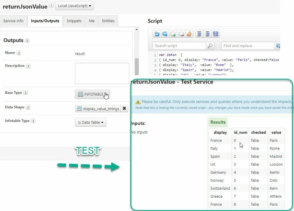

What should be here the possible solution/ workaround:
- to use instead of  list from javaScript a twx service. So you can simple define such service which should  send json fille to the External data:
Where the twx service is defined as:
var data= [
{ id_num: 0, display: "France", value: "Paris", checked:false },
{ display: "Italy", value: "Rome" },
{ display: "Spain", value: "Madrid"},
{ display: "UK", value: "London"},
{ display: "Germany", value: "Berlin"},
{ display: "Norway", value: "Oslo"},
{ display: "Switzerland", value: "Bern"},
{ display: "Greece", value: "Athens"},
{ display: "France", value: "Paris"}
//get the first row for the dataShape defintion
var FirstRowJson =data[0];
//create an empty Info Table
var resInfoTable = { dataShape: { fieldDefinitions : {} }, rows: [] };
//defines the dataShape
for(var prop in FirstRowJson)
 if(FirstRowJson.hasOwnProperty(prop))
 if(prop == "id_num")
 resInfoTable.dataShape.fieldDefinitions[prop] = { name:prop, baseType: 'INTEGER' };
 else if(prop == "checked")
 resInfoTable.dataShape.fieldDefinitions[prop] = { name:prop, baseType: 'BOOLEAN' };
 else
 resInfoTable.dataShape.fieldDefinitions[prop] = { name:prop, baseType: 'STRING' };
//add the rows to the InfoTables
for(i in data){ resInfoTable.rows[i]=data[i]; //copy one to one
 resInfoTable.rows[i].id_num=i;
 resInfoTable.rows[i].checked=false;
result = resInfoTable;
I used such service here for the repeater-1 and it worked fine.

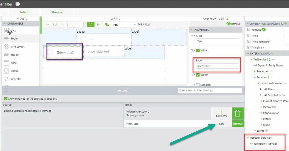

  Now I will   set a binding between Studio parameter "ItemList" and the value of the checkbox with a filter:
And here the following definition of the filter:

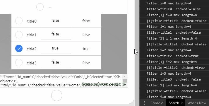

 if(!window.my_filter) window.my_filter=1;
 else {
 if(window.my_filter>= value.length) window.my_filter=1;
 else {window.my_filter++;} }
 console.log("Filter i="+(window.my_filter-1)+" max length="+value.length)
 console.log( "title:=" +value[window.my_filter-1]['title'] +" chcked:="+value[window.my_filter-1]['checked']);
 return(value[window.my_filter-1]['checked']);
there the console.log was only for debugging and should be removed from the real filter. Also for each filter the global variable should be different (because we can face the problem that more different filters will increment the same global variable in the same time and we will have a very erroneous results )
So, when I test it in preview mode:
