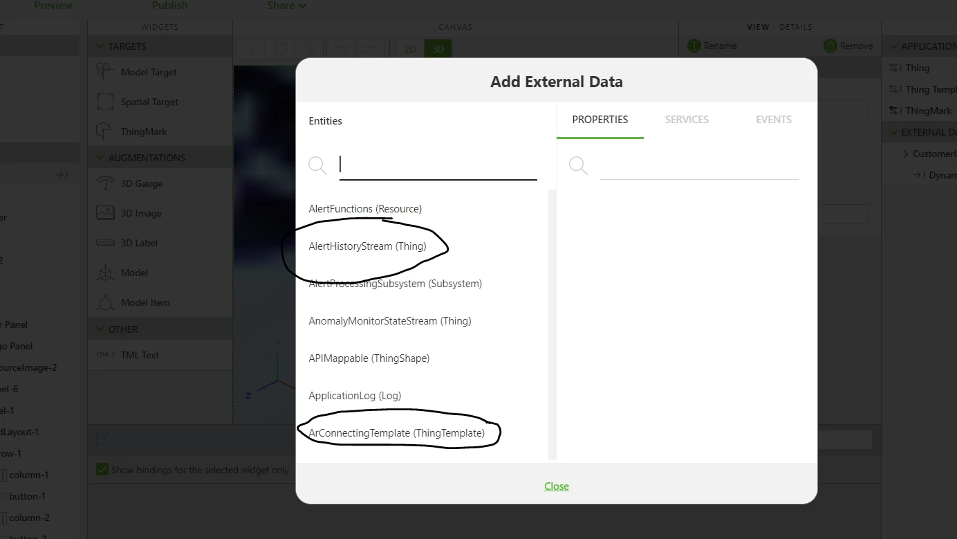

How to use Application Parameter's Thing Template in studio
What is the purpose of using Thing Template as an application parameter in Thingworx studio?
How to dynamically the properties of the Thing Template in studio?
I have added Thing Template's service "GetImplementingThings" in studio but I am unable to fetch the properties stored in the "Things" which extends the Thing Template.

Application parameters are parameter which you can create and use in your JS code in studio .For example i created an application parameter with name count and can use this variable in my JS like $scope.app.params.count = 0
If you want to access properties/services that are there in your hosted Thingworx (Which is connected to your studio)  you can click on the (+) sign of external data below application parameter and from there you can fetch Thingname/Template name and this will give you a list of properties/services which you have created or inbuilt to the template .From there you can get data in your Studio .

How to use the "Thing Template" application parameter in studio.
How to load the Thing Template Properties in the studio?
Jun 4, 2018 1:11 PM UTC
If you want to access properties/services from the ThingTemplate Which is there in Thingworx (Hosted thingworx which is connected to Studio) .Then you need to click on the external data (+) sign and select the template/thing from there and select properties or services which you want to use in Studio .I have also attached the screenshots for this .
