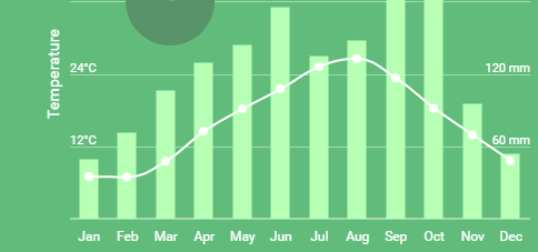

Ankit Gupta​, i don't want to get data from Thingworx, i want to call the function in my .js file , in the function i will create data manually in same format as we get from thingowrx. the real question is , in my chart if we have four vertical along y-axis , i want to change the color of only one vertical dynamically based on data we are providing.if the data is less than 12, it should be fill red color.
for eg. we have chart  Tempreture vs Month graph, i want to fill the red color to my verticals if tempreture is less than 12 degree Celcius. This is my actual requirement .
