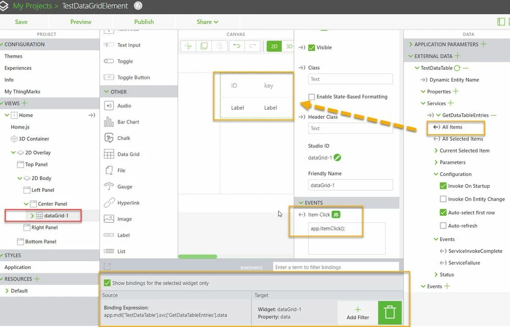

For example, When a specific row in the data grid is selected, it would display a popup with labels that follow the rows items that was clicked on.
July 1, 2020
Hi @Jimmy4 ,
you can use the following options.

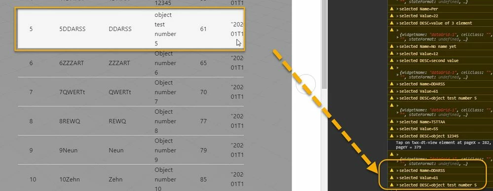

The one option is to use directly the Item click.  You can define a code e.g.:
$scope.app.ItemClick=function() {
//console.warn($scope.view.wdg['dataGrid-1'])
 $scope.$applyAsync();
 console.warn("selected Name="+$scope.view.wdg['dataGrid-1'].data.current.Name)
 console.warn("selected Value="+$scope.view.wdg['dataGrid-1'].data.current.val)
 console.warn("selected DESC="+$scope.view.wdg['dataGrid-1'].data.current.Desc)
And then when we test it - we will have:
