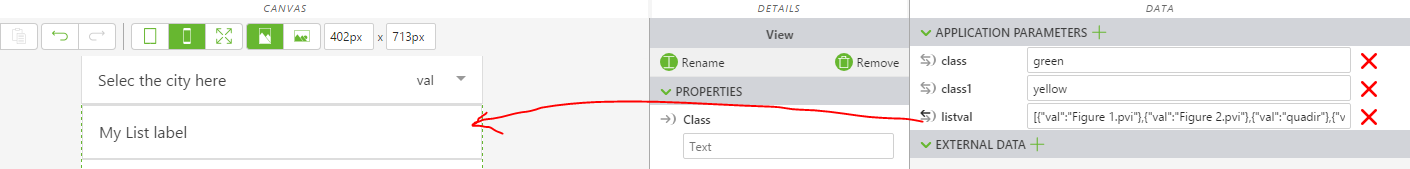

Hi Giri, I have created an application parameter listval which holds  [{"val":"test1"},{"val":"test2"},{"val":"quadir"},{"val":"umar"}] values in json format. I bind it with my list and choose binding target property as list. I save and preview the project, Nothing is appearing in my list. list.PNG
July 6, 2018
I had the same issue too.
Select Widget doesn't accept json list format.
It uses only INFOTABLE format provided by ThingWorx.
So, the solution is to create a Thing and a Property with an INFOTABLE Base Type.
Please refer to this article to have the steps to apply this solution :
Best regards
