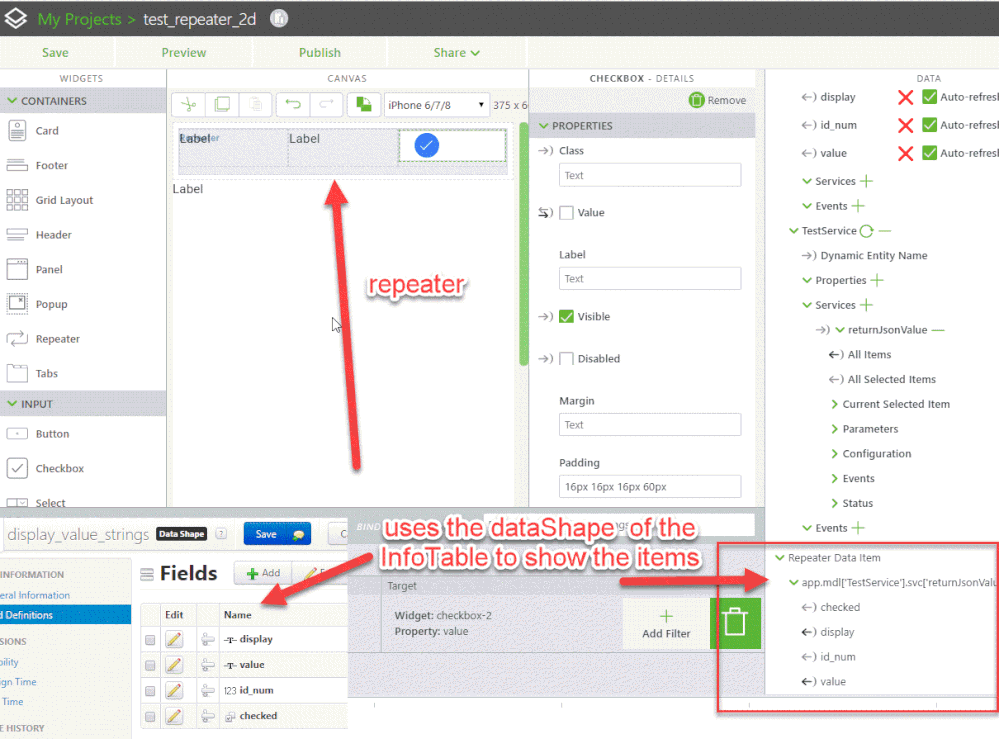

I want to have a varying numer of check boxes that shall be generated automaticly from a list without thingworx.
So I dropped a repeater in the 2D Canvas and added a check box to it. I generated an application parameter called APCapitals and dragged it on the data panel of the repeater. So far so good.
How do I get the names displayed in the checkboxes?

Hi @whity,
I am not quite sure but I do not think that this will work for the repeater without using of Thingworx external object.
When we set a Json to the repeater data  - this  seems not to be enough that the repeater will work.
So, I tested it from Thingworx, where I generated an InfoTable and tried to use it in the Studio external data but in this case it was also not working. First when I assigned to the output InfoTable an explicit datashape- then it  was able to display  the items of the table. We need the items in the Repeater Data Item section to be able to create the bindings of the infoTable fields to the particular widgets on the repeater. I have the impression that this is required – I did not check more deeply the implementation in Studio
May be, this is not the best solution, but I use the following approach which seems to work.
First is to create in Thingworx a service which generated the list as infoTable. The output is an infoTable where I am using explicit datashape object (means it not temporary created by the service) which defines the items what I want to see in the external data in studio (def scope should be the same or subset of the infotable fields)
Example for the service  TestService.returnJsonValue() :

//get the first row for the dataShape defintion
var FirstRowJson =data[0];
//create an empty Info Table
var resInfoTable = { dataShape: { fieldDefinitions : {} }, rows: [] };
//defines the dataShape temporary
for(var prop in FirstRowJson)
 if(FirstRowJson.hasOwnProperty(prop))
 if(prop == "id_num")
 resInfoTable.dataShape.fieldDefinitions[prop] = { name:prop, baseType: 'INTEGER' };
 else if(prop == "checked")
 resInfoTable.dataShape.fieldDefinitions[prop] = { name:prop, baseType: 'BOOLEAN' };
 else
 resInfoTable.dataShape.fieldDefinitions[prop] = { name:prop, baseType: 'STRING' };
//add the rows to the InfoTables
for(i in data){ resInfoTable.rows[i]=data[i]; //copy one to one
 resInfoTable.rows[i].id_num=i;
 resInfoTable.rows[i].checked=false;
result = resInfoTable;
