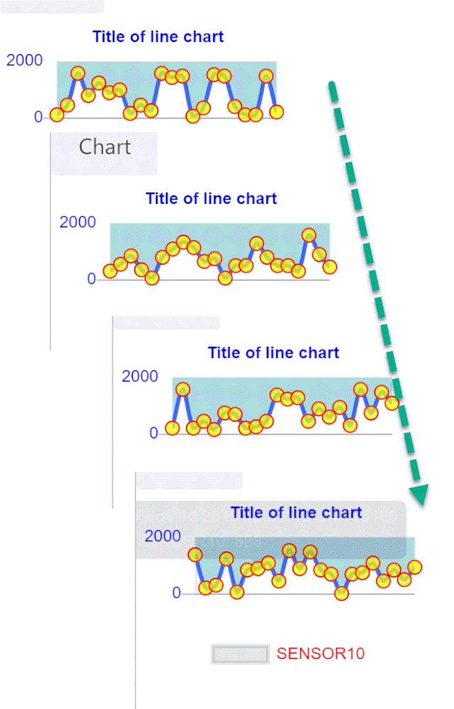

how to use time Series Chart?
I bind $scope.app.params["timeSeriesChartData"]
How should I organize $scope.app.params["timeSeriesChartData"]?
where is example( time Series Chart )?
Nov 15, 2019 12:41 PM UTC
Tested and it worked .
1.)Set the data using $scope.setWidgetProp()
Example:
 $scope.$apply(()=> {
 $scope.setWidgetProp('timeSeriesChart-1','data',myData)
2.) set the data to empty before setting with new value e.g.
 $scope.setWidgetProp('timeSeriesChart-1','data',{})
3.) update data async e.g.
 $scope.$applyAsync($timeout(function() {
 $scope.$root.$broadcast('app.view["CHAR2DVIEW"].wdg["timeSeriesChart-1"].svc.updateChart')
 },150))

i used this way, I don't know if this is the right way.
Ex ) Bar Chart
$scope.app.params["BarChartData"] = [
    {"XAxis":"Brush","YAxis":0},
    {"XAxis":"Pin","YAxis":100},
    {"XAxis":"Link","YAxis":200},
    {"XAxis":"Spkt","YAxis":300},
    {"XAxis":"Shoe","YAxis":400}
I bind BarChartData  and Test code
    for(var i = 0 ; i < $scope.app.params["BarChartData"].length ; i++ )
        RandValue = RandomInt(0 , 600 );
        $scope.app.params["BarChartData"][i].YAxis = Number(RandValue);
    $scope.app.fn.triggerWidgetService("barChart-1","updateChart");
it is well
i want to use this way.
how to make Data for  time series chart?
link this
$scope.app.params["time_series_char"] = [ how to make ....]
wxywxy11-VisitorAuthor
Nov 5, 2019 6:54 AM UTC
I can use Time Series Chart
I can use it the same way as Bar Chart.
I can't display Time Series Chart because construct  error
