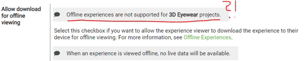

To my knowledge the info "Offline experiences are not supported for 3D Eyewear project is not correct.
Also "no live data will be available" is also quite incorrect. Thingworx data will not be available, but data e.g. from rest API will be displayed.
