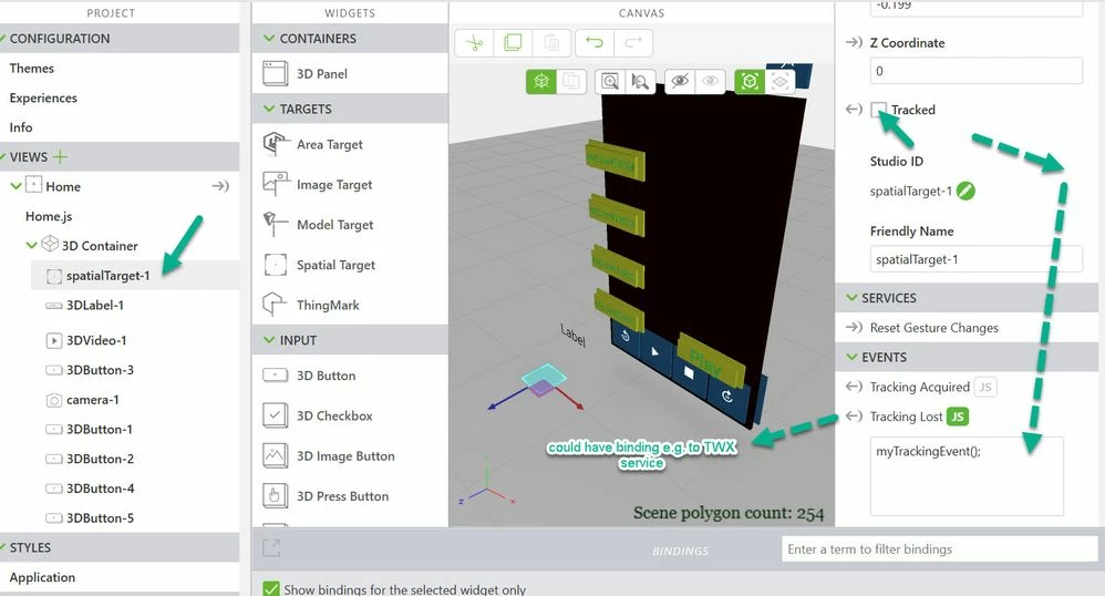

How to walk around the model in Spatial Target
Dear Community,
    I have one model and i want to walk around it after placing it. This is possible in the Area target which i have tried. But i am unable to walk around the model in Spatial target. Any one has an idea about it? Please let me know...
With the camera when i detect the twin its always ahead of me and i cannot walk around it or through it..
Thank you!
There is an option called track and i dont know that either i have to bind it with something... please let me know if anyone has an idea about it.

Hi @MA8731174 ,
the tracking box  means when  you set it then it will activate the trackings events - so you will have then tracking events (that means on your picture Verfolgung für das positionieren von ARKit on IOS or ARCore Android   Target) You can define or bind these events to handle / when e.g. the target will  lose its position or was moved on some kind. Let say you set the target where you wanted to have specific position and then you will check the model. You possibly want to know if still the model has the origally selected position. In that case you can track the Tracking Lost event - so by binding or defining of some js funciton which could be call form the JS box2024-11-07_11-24-13.jpgS box.
