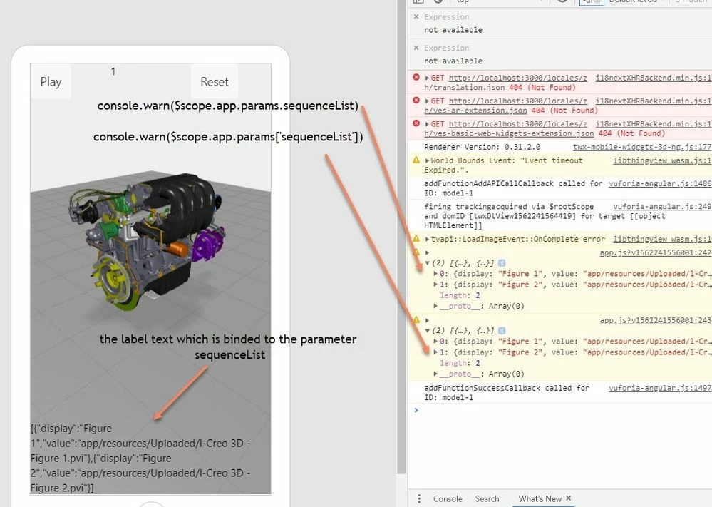

The code above will soyely lead to set a parameter to this list. But nothing else. So in the example I bound this parameter to label and laod it. Here e.g. it will looks like:
In the picture we can see the the label which display the list content - but also we can see in the console printings of the console.warn.
Therefore I think that this is not the code what could achieve your intnet.
