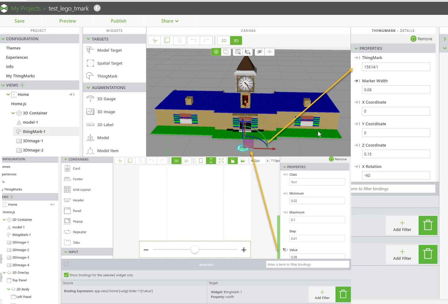

Hi, I'm new in Thingworx Studio.
I want to zoom whole view by using javascript code like when zooming in and out using mouse wheel.
It's not just scale the only one 3D model, it's same zooming function as mouse wheel event.
Is it possible through javascript or other functions?
and is it possible to set certain zoom level at window open through sending GET request to Content Delivery Service with URL such as /ExperienceService/content/projects/myproject?

@dupatel In case I have not only 3d model but also many 3d labels or images,
I want to zoom whole 3d container not only scale one 3d model via javascript.
It could be the same feature to scroll with mouse wheel.

so the possible options could be (also already mentioned) :
1,) scale the model and all 3d items - not really a good solution. Here you have to pay attention that the scale will change all offset distance , may be , in unwanted  directions- so remember you will scale all distances along the default coordinate system and depending on you position you will have some unwanted movements of the model.
2.) An other option is you can move your experience (3d model) away from the Thingmark in ,x, y z but , I am not sure if it will be easy to specify the vector away form you viewpoints.May be possible but have no idea who to do this.
3.) my favorite here will be to scale thingmark,
In the project on the picture the thingmark size is 0.08 using a slider I will change the Marker Width from minimum 0.02 to maximum 0.1 by step 0.01. This will do not have any effects in the Thingworx studio preview but on the end device (Thingworx view on Android device - here tested in S8) was working fine.
So behavior is the following - when you increase the Marker Width property it make with the same factor the experience smaller and opposite direction. Here is important for the correct scaling the thingmark has not so large offset to the model default coordinate system because remember that  the offset distance will also increase.
