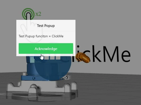

One possilbe usage is to use $ionicPopup service -  here some examples
var my_msg_data={
 title: '', // String. The title of the popup.
 cssClass: '', // String, The custom CSS class name
 subTitle: '', // String (optional). The sub-title of the popup.
 template: 'This is component InfoView', // String (optional). The html template to place in the popup body.
 templateUrl: '', // String (optional). The URL of an html template to place in the popup body.
 okText: '', // String (default: 'OK'). The text of the OK button.
 okType: '', // String (default: 'button-positive'). The type of the OK button.
$scope.app.TestPopup=function(my_comp){
 my_msg_data['title']='Test Popup';
 my_msg_data['template']="Test Pupup funciton = " + my_comp;
 my_msg_data['okText']='Acknowledge';
 my_msg_data['okType']='button-balanced';
 var alertPopup= $ionicPopup.alert( my_msg_data);
 alertPopup.then(function() {console.warn("then branch of popup called");} );

and test in preview mode
