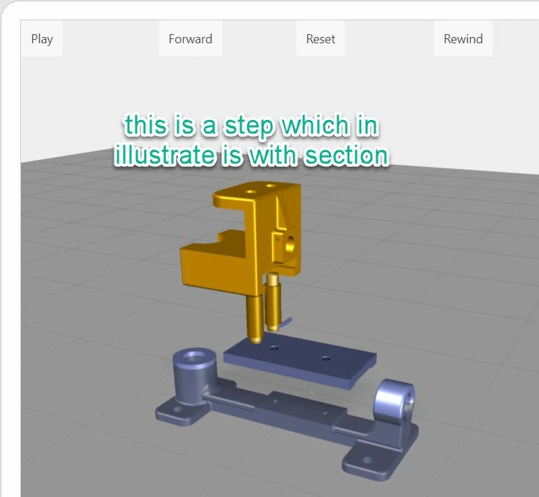

Hi there,
It used to work fine to preview Section created in Illustrate Sequence with Vuforia Studio.
But not it's broken, still visible on devices.
How to fix it?

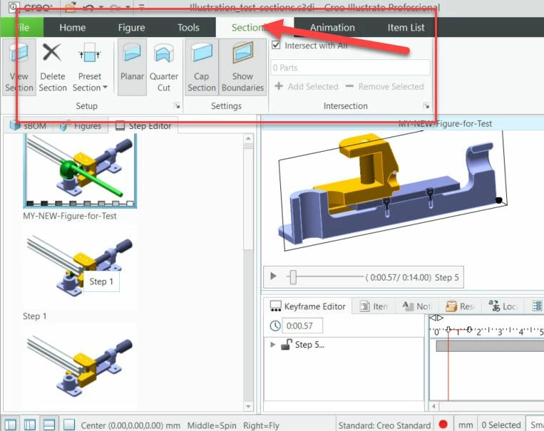

But I was not able to see the section/s created with sectioning tool in Creo Illustrate - also the section was not visible also in preview mode:

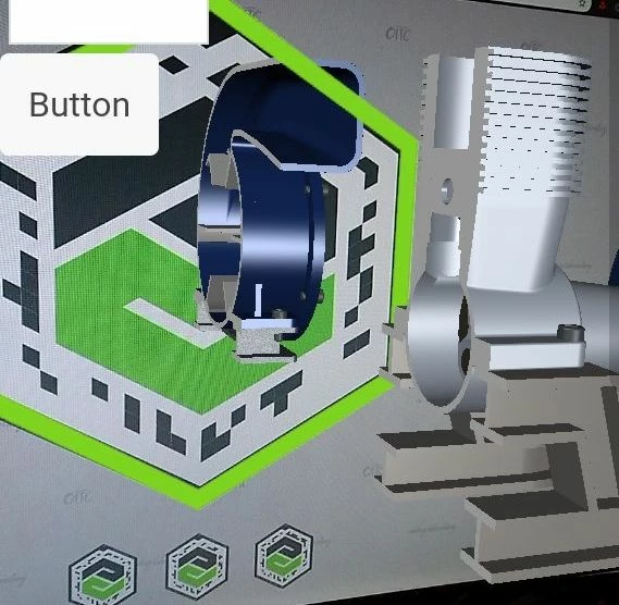

Otherwise  I want to referrer to possible workarounds discussed in  following posts (one we discuss regarding similar issue in the past) :
How to accomplish real-time Sectioning function like this?
and
Re: how to add section view in studio ?

Yes, I created the section by the sectioning tool in Creo Illustrate.
I'm using Illustrate 6.0.0 and Vuforia Studio 8.5.5 as well.
With default settings.
By the way, the Still Section I created is in a static Figure, no Sequence/Animation in it.
Have you tried publishing the experience and open it with Vuforia View on mobile device?
It works.
Even it is not visible in Preview mode.
