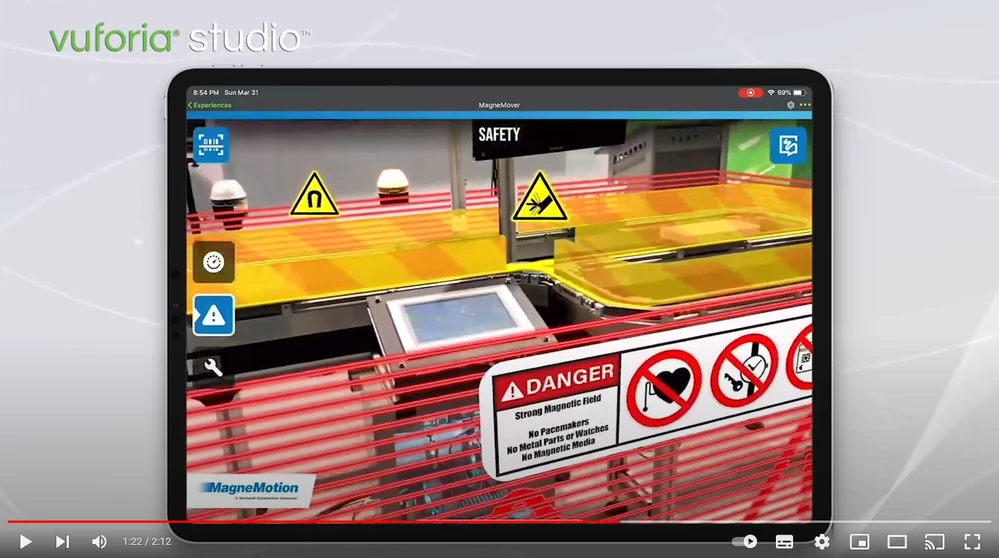

I created an Area Target with Vuforia Studio.
How to implement a Danger Zone within an Area Target as in the PTC video?
video link : https://www.youtube.com/watch?v=Fwikx1TOidE

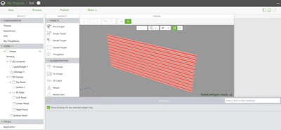

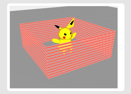

Hi @hno ,
The way i think could be simply using a png image and creating the required grid box using the 3D-Image.
To make it more easy, i am attaching a png file of Red lines zone and studio screenshot
Let me know if this works for you
Best Regards,
Mohit
