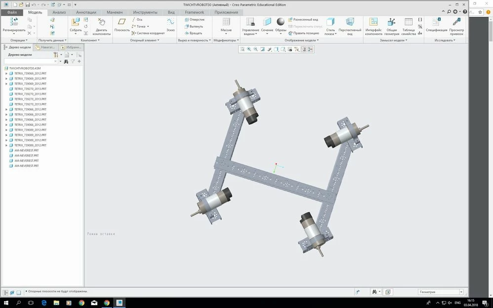

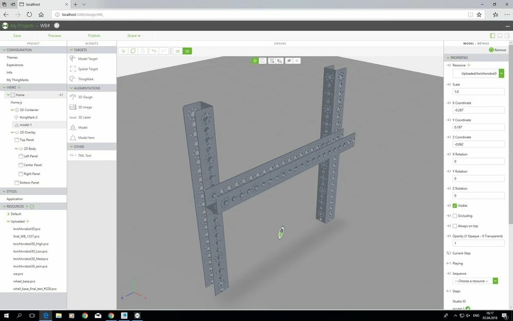

Import 3D Creo model to AR ThingWorx
I made assebly in Creo Parametric 4.0 then input it to AR ThingWorx. It`s not full and i can get full assembly only if i change .asm to .stp but it not good enough for my project.creo.jpgthingworx.jpg

Apr 3, 2018 5:50 PM UTC
Have you tried saving the .asm as a pvz in Creo and importing it to Studio? When you change the .asm to .stp, do you have parts still missing?

Apr 4, 2018 5:28 PM UTC
Thank you. Now it works. If I open this Step file in Creo it is not looks like it was assembled, but in ThingWorx it does
