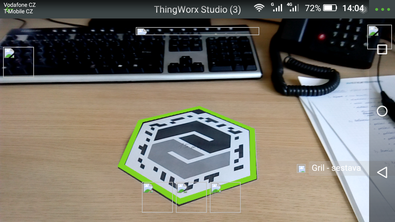

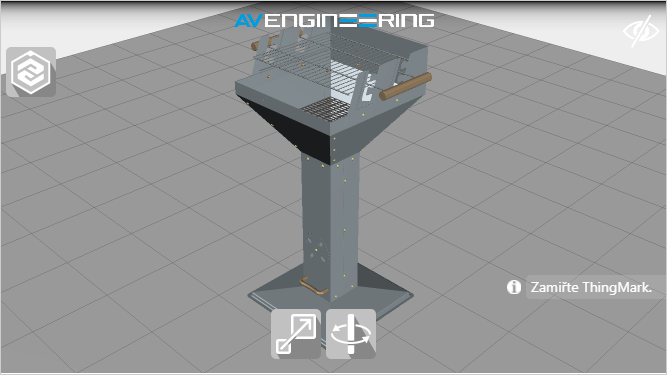

I found a problem, when I try to create a copy of my projects for showing new models.
When I make copy of a project via Save As or Export/Import, project look correctly in preview:
but in ThingWorx View (in device) does not load any resources (images/model):
Has someone the same promblem or a solution  ?
Thank you for each reaction.
Regard
Tomas
August 15, 2017
Tomas Charvat​ Did you try restarting ThingWorx Studio Application and opening the project? I guess this should either be a project upgrade issue or else user permissions - as I can see broken image links in your screenshot.
