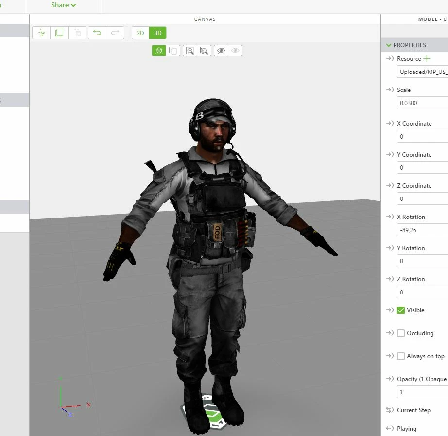

@BryanPark,
 Export from blend into .FBX  or collada format and import file into Vuforia Studio.
 this is my results.
 Bye
Giuseppe

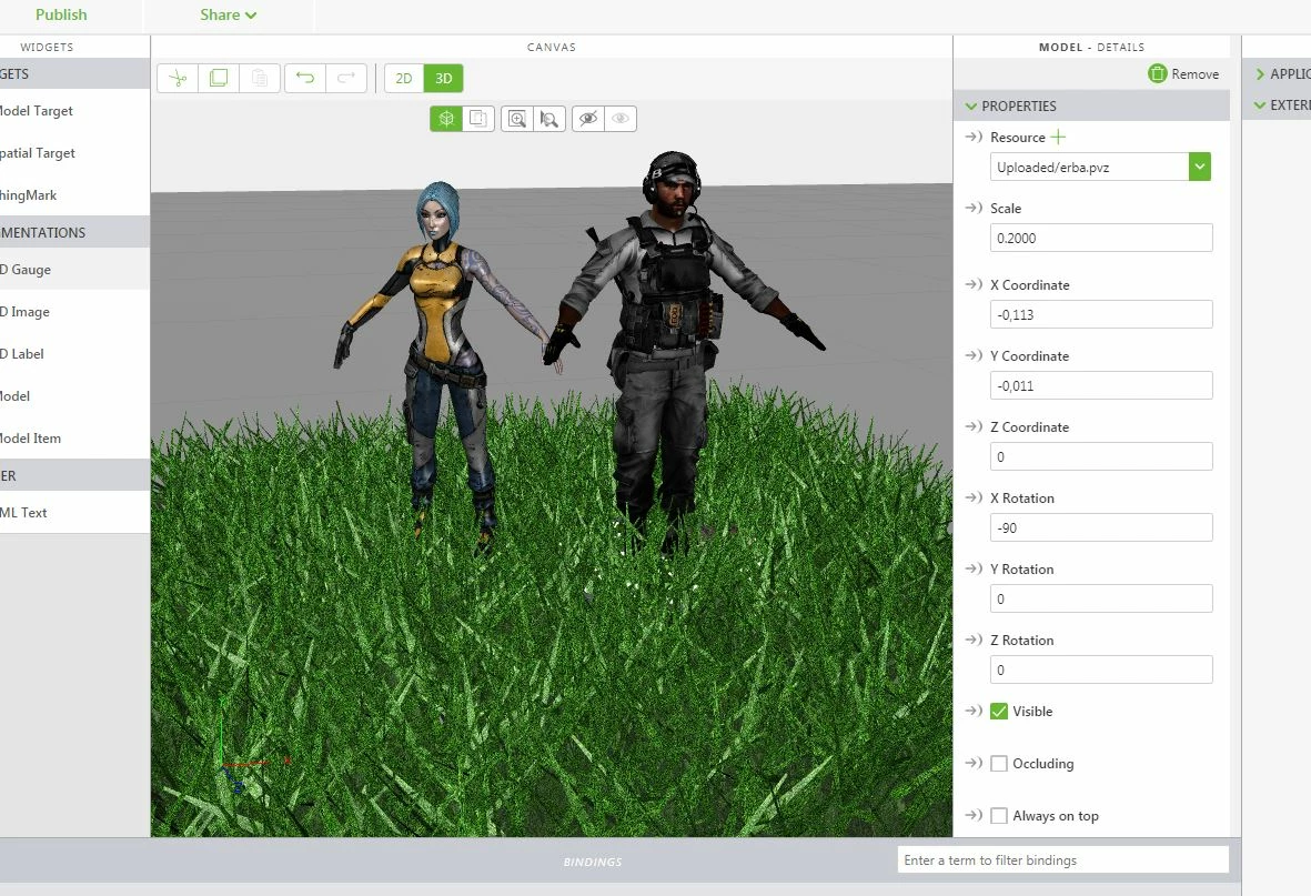

Jun 22, 2018 1:08 PM UTC
can i ask you the model 3d and textures, i want try to create a pvz for you  for vuforia studio.
Thnx
Giuseppe
I used many model with textures into vuforia without problem.
