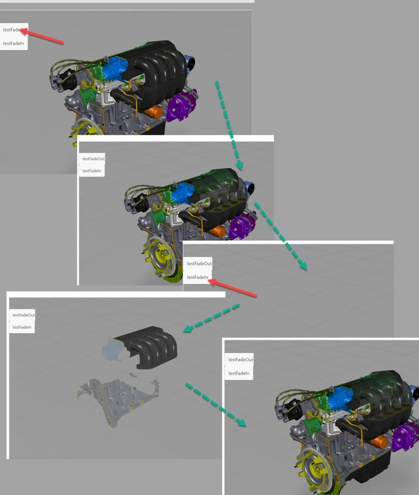

Here an example where I tested it and it worked fine:
In the sample project here I have 2 functions: FadeOut and FadeIn . The FadeOut function will "FadeOut" the opacity of particular widget for a  time / time inerval / from current value  to 0 and the function FadeIn will increase the opacity In a time inerval from 0 to a specific value:

//=============== Button function
$scope.testFadeOut= function()
$timeout( ()=>{$scope.fadeOut($scope.view.wdg['modelItem-1'],2000,200) } ,500)
$timeout( ()=>{$scope.fadeOut($scope.view.wdg['modelItem-2'],4000,200) } ,1500)
$timeout( ()=>{$scope.fadeOut($scope.view.wdg['modelItem-3'],6000,200) } ,2500)
$timeout( ()=>{$scope.fadeOut($scope.view.wdg['model-1'] ,5000,200) } ,3500)
//====== second button function
$scope.testFadeIn= function()
 $timeout( ()=>{$scope.fadeIn($scope.view.wdg['modelItem-1'],0.8,2000,200) } ,500)
 $timeout( ()=>{$scope.fadeIn($scope.view.wdg['modelItem-2'],0.9,4000,200) } ,1500)
 $timeout( ()=>{$scope.fadeIn($scope.view.wdg['modelItem-3'],1.0,6000,200) } ,2500)
 $timeout( ()=>{$scope.fadeIn($scope.view.wdg['model-1'] ,1.0,5000,200) } ,3500)
The sample mobile Studio  project was uploaded
