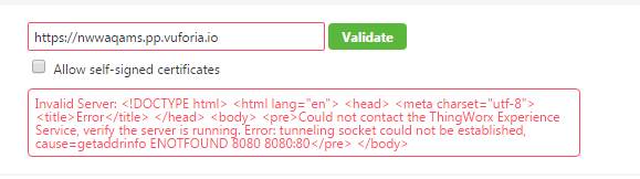

We have looked into the ES settings and when we try to validate them we get this:
We can contact the server via Chrome so we have the correct password.
Per

Since in this case you can use Chrome to access the URL, this appears to be related to the Settings for Thingworx Studio. This looks to me like some sort of invalid proxy specification is in place. 8080 8080:80 is definitely not a valid IP address.
Is there a proxy in place at the company? Check it via Chrome's advanced settings. If there is one in place, you need to use the same settings in Thingworx Studio. It will not automatically adopt the browser settings.
