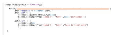

Hi @RolandRaytchev ,
Thank you for your reply.
I did a simple test using public API to fetch some data and display on label widget. It works well.
However, as you mentioned about CORS, I do have problem to fetch data using my company API. It will return CORS error.
How can I work on this?
Below is my code and error returned.
Thanks.

Hi @NA_nur ,
CORS setting is something which is not related to Vuforia Studio but more to browser functionality.
- You can check if the behavior is different when you use the mobile platform. The chrome is only test system and the mobile platform could have sometimes different behavior
Some more detailed information explaining CORS  - possible reason and  workaround could be found there:
https://developer.mozilla.org/en-US/docs/Web/HTTP/CORS/Errors/CORSMissingAllowOrigin
and
Another point is : you mentioned that the normal API was working. What does it mean?
If a simple fetch request is working , in this case you can use some simple web server as proxy . The  web.server e.g. node.js server – could be used to translate your API to more simple request where only the information is passed. If such solution is possible depends more of the details on the specific application case
