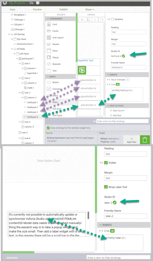

thank you for the very detailed description.  So now every think was clear. So , I started to test the issue but had some difficulties. So, have some widgets:
As shown in the picture I defined a function which does some printing in the console and called it from the click event of the widgets / setup the click event in the UI

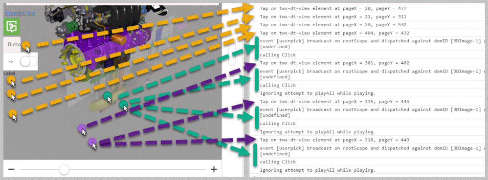

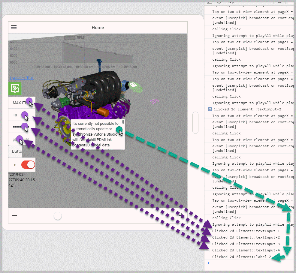

When tested it in preview:
I was able to see the printing for an userclick on the widget area when the widgets are visible.
After making the widget invisible I was not able to emit a click events for the hidden widgets clicking on the area where I will suppose the their position-> this was the case  for 2d tested elements. The only possible click event was possible for the 3D elements like Modelitems and 3dImages (this behavior I know also in the older releases) :
So, to summarize - I was no able to reproduce the issue yet. What is different in your case? What should I change in my test to be able to reproduce your problem?

Ok I see here you mentione the "userpick"... so I used in the past some costruct for 3d components like:
angular.forEach( //==== for each 3d model block
 // this will call the function below for each 3d model
 $element.find('twx-dt-model'), function(value, key) { //for each 3d model block function
 angular.element(value).scope().$on('userpick',function(event,target,parent,edata) {
 // start the $on() listener 'userpick' + function definition
 console.log('target');console.warn(target);
 console.log('edata');console.warn(edata);
 var pathid = JSON.parse(edata).occurrence;
	 $scope.currentSelection = target + "-" + pathid;
In this case I could expect that this customized userpick , could start also  for invisible elements . For 3d componets in the sample code above  it will fire. In this case then simple check the visibility property and exit if the element is not visible
