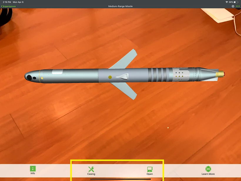

The image below is from one of the default experiences that comes with vuforia view and shows the bottom panel in the experience being placed above bottom bar that iOS uses. Boxed in yellow
Home Bar Blocking Experience WorkscreenHome Bar Blocking Experience Workscreen

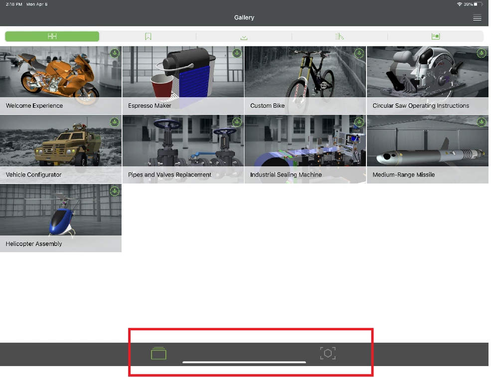

The image below is from one of the gallery view in vuforai view, notice that the iOS bar does not block off the workspace of vuforia view. Boxed in RedHome Bar overlapping with Vuforia View WorkscreenHome Bar overlapping with Vuforia View Workscreen

No, This behavior is nor reproducible in any App, for example the Vuforia View App has this small horizontal bar overlapping with the bottom of the workscreen, as shown with the red box.Home Bar overlapping with Vuforia View WorkscreenHome Bar overlapping with Vuforia View Workscreen
Where as in the Vuforia View Experiences, it appears to cut off the workscreen, or define a new bottom maybe in this image with the blue box.
I can not speak to an iPhone because I do not have one with a Dock bar. But on an iPhone 7 this issue does not occur. Notice the bottom baner boxed in blow. This is the same experience as the image above but viewed on a iPhone 7.

Jul 14, 2020 10:06 AM UTC
@CliffRice
If you add following lines of code to your Application tab (css), this should work. Ensure to apply the additional classes found in the @media to the correct objects, if wanted. Additionally, add a background color to the Top and Bottom Panel.
//iPhone Notch portrait mode
ion-side-menus.view {
 left: 0px;
 width: 100vw;
 padding-left: env(safe-area-inset-left);
 padding-right: env(safe-area-inset-right);
//iPhone Notch landscape mode
ion-nav-view.view-container {
 height: 100vh;
 padding-bottom: env(safe-area-inset-bottom);
@media only screen and (orientation: landscape) {
 //Assign class to most left column in footer
 .columnLeft {
 margin-left: env(safe-area-inset-left);
 //Assign class to most right most column in footer
 .columnRight {
 margin-right: env(safe-area-inset-right);
@media only screen and (orientation: portrait) {
 //Assign class to the first gridLayout in the Bottom Panel
 .bottomPanelGrid {
 margin-bottom: env(safe-area-inset-bottom);
