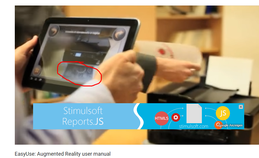

I want to make an augmented reality manuals (something like this EasyUse: Augmented Reality user manual - YouTube ). For that I need object recognition facility in thingworx studio.

From what I see in the video, it is relatively possible with TWX Studio. To replicate the similar Printer AR, you might need to have supportive 3D models arranged in a greater precision within the Studio Experience Project. For the Object recognition, if you could manage to arrange the ThingMark and the 3D models in accordance with each other - then ThingMark will act as a recognition facility for Printer and the playing animation sequence could deliver the desired experience.
In the other case, you can also replace the real printer with Digital (3D model) printer and its corresponding animation sequence.

This is normal image target tracking in the video.
You could however do model target / cad based tracking with studio from next week on - or perform the same with marker/ image targets /thingmarks with studio today.
