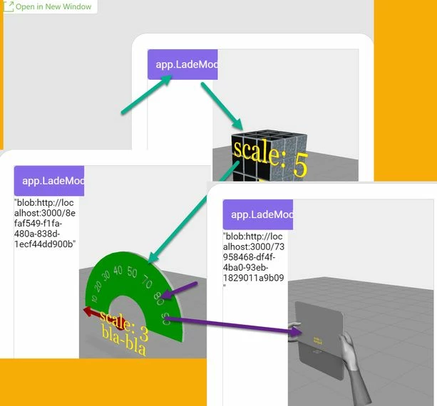

code is not really a good programming style example ... but tested in the 9.21 with project and it worked - tested now in preview - is ok. So far I see your issue is in preview - so frist there to check. I will attach a demo project

Also you need to add LoadBinary into the external data section / so first remove the old objects and recreate the bindings again
Also,please,  take care that LoadBinary service has the correct permission in TWX  but I think that is something what you alreay set ... so regarding  the status of the provided pictures
I hope that helps! If not then, please , let me know. Thanks
