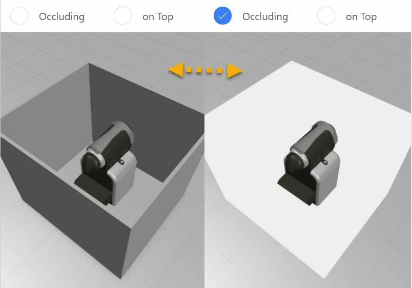

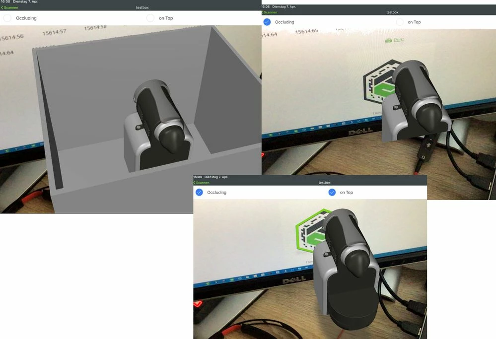

here / at least for me/is not clear what is the issue. I believe / not sure/ you want to occlude some geometry? Do you mean that some occluding effect is not working? Could you provide more details?
According to the help - Occluding: If set to true, the geometry of a widget is invisible, but at the same time hides any other augmentations behind it in the 3D scene.
Therefore, the background or camera feed appears where the occluded widget should be. This can be used to emphasize some augmentations by hiding surrounding 3D geometry.
example In preview mode:
and then on IOS:
