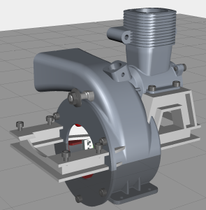

I'm also seeing this issue.  In my case, I have a multi-level assembly and I want to create a Model Item for a sub-assembly.  I drag the Model Item widget onto a part that belongs to the sub-assembly and everything is OK, even if I save the project, exit out and then come back in again.  But then I edit the properties of the Model Item and change the Component Occurrence to select the sub-assembly.  At this stage it looks OK on screen, but if I Preview, or exit and come back in to the project, the whole sub-assembly has moved to a new location. as shown:

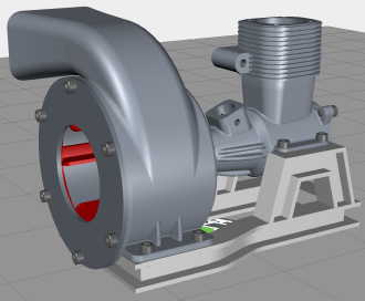

If I remove the Model Item widget, then the sub-assembly immediately moves into the correct position:
